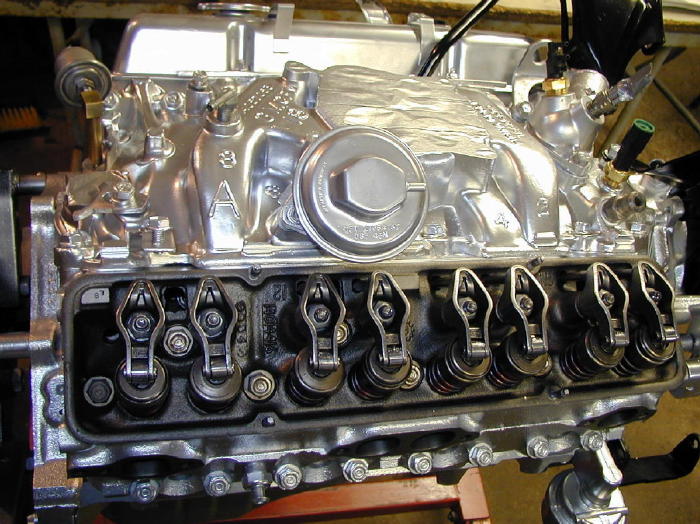

But here's a nice glory picture

Ok I think I may have adjusted mine wrong. I adjusted the rods until I could not spin them in my fingers any more and then went 1/2 turn , I understand now that it should be when the rod will not move up and down any more. So can I adjust the lash now that I have assembled see pic below. how can I do this ? is it possible or do I have to install and adjust running. I don't wan to take apart and I don't want to adjust while running if you look at pic you will see why. any help guys?
