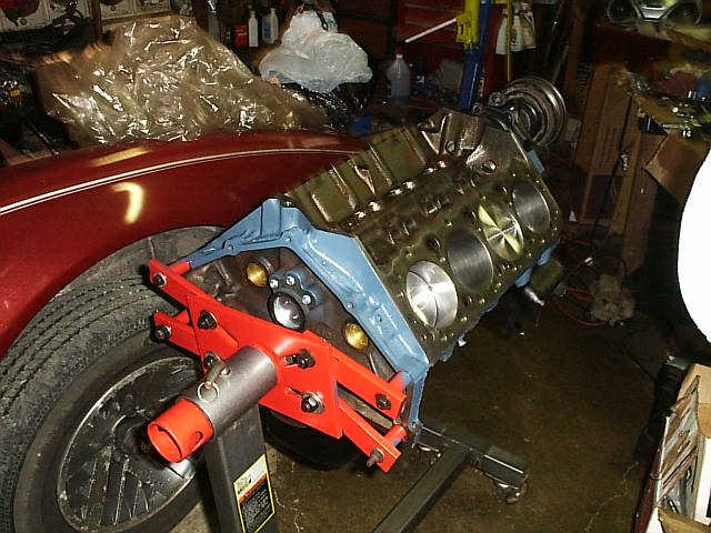

I set out to build this block 7 years and 3 cars ago. Time to put those parts to use!!! Here is what it looks like so far

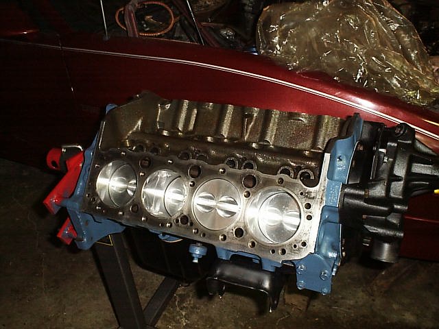

here is the new one, I have sunk $2K in the motor and trans so far.

pretty, but I got some paint on the engine stand, oh well

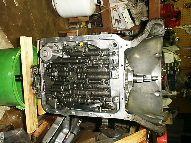

the tranny is getting the works too

I did a master rebuild kit, new drum, and bought a new "super pump" instead of trying to build up the old one. I finished the shift kit and got a Vette 2050 stall converter. It should work out real nice. I hope to get my heads back tuesday, I am having bigger intake valves put in.

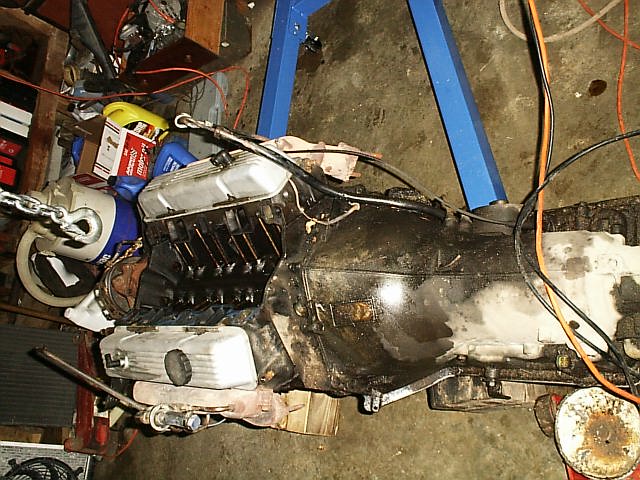

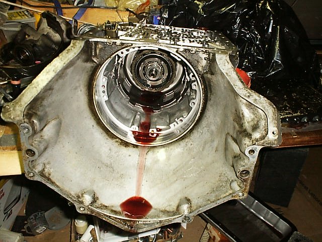

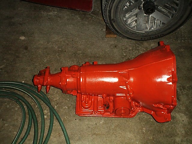

this color looked better on the rattle can cap, oh well. Tranny is ready to go

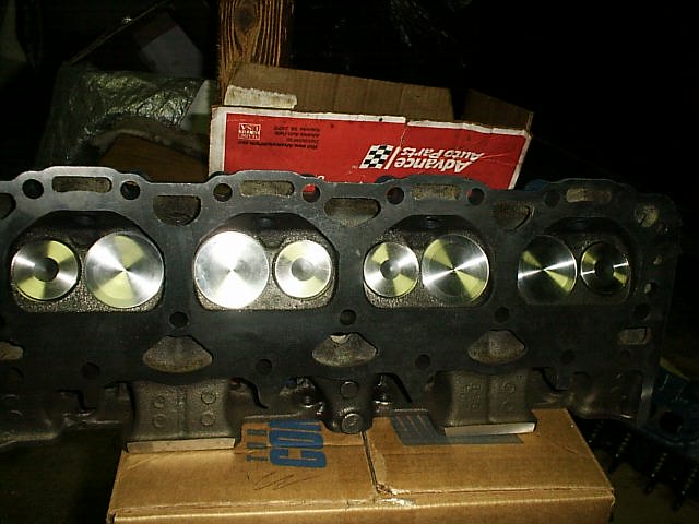

305 heads now have 1.94 intakes, manley valves, comp springs and roller tip rockers

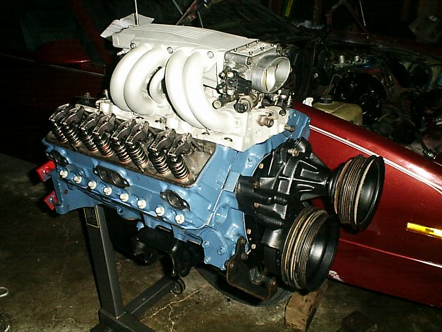

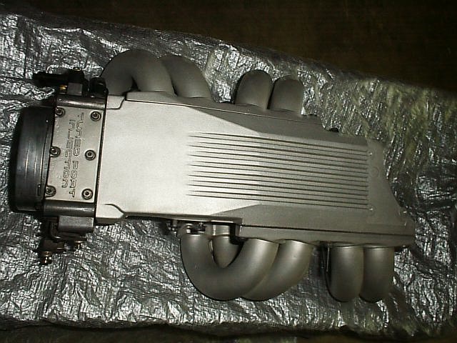

looks good, but .....OOPS!!!! I didnt notice that I put the top pulley on backwards till I saw this picture, I must be working to hard.
Does anyone think I will have clearence problems with these 1.52 rockers and stock valve covers?

Car: 92 Camaro
I would have done some unshrouding on the cylinder head chambers when those big valves were installed, looks like that's going to hurt the flow some.
I sure hope not.
My new cam gives .449 .456 lift so I didnt think that would be enough for shrouding.

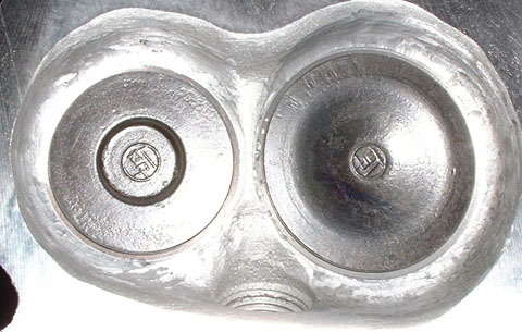

That's even worse that you have a small cam, shrouding will be worse at low lift because the valve can't get away from the edge of the chamber at low lift. Look at this pic of a head that has had the valves unshrouded and you will see what I'm talking about, then look at your head.

Hmm, the machine shop did remove some chamber material around the side of the valve, I just thought they were sloppy while cutting the bigger seats. Did they do this to deshroud it? or just for clearance?
