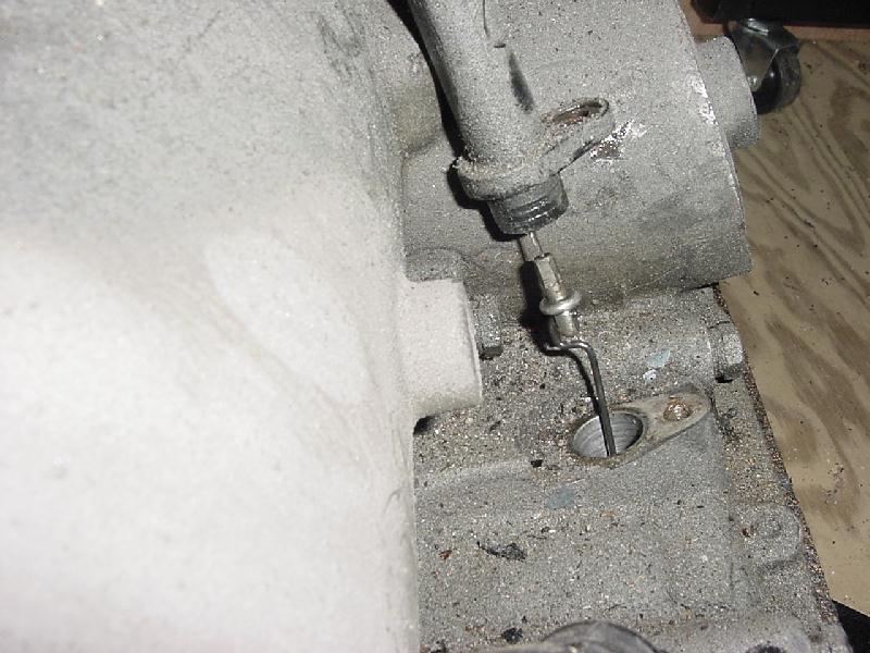

I had to loosen my TV cable from the carb so I could feed the line through and connect it to the trans. Then when I went back to put the line back in, I couldnt get the line to "release" so I could re-attach it to the carb, and then set the TV cable.
My trans is still lowered a little bit, but I dont think it should make that much of a difference should it? I should still be able to feed it through and such, right?

Sellmanb, the TV cable should have some slack in it, and when you pull on it, you should be able to feel it moving the valve in the trans (there will be some resistance). It should be further out than in your pix.

For the TV cable, get a helper. Unbolt the cable from the trans, and unhook it the from the thing inside the trans. Hold the hook end of the cable while having a helper pull the other end that hooks to the carb. Make sure it moves freely inside the cable housing. Grab the piece coming out of the trans, and make sure it moves also. Hook the cable back up to the piece in the trans, and have a helper pull gently on the other end of the cable while you slide the cable housing into the trans (to remove any slack in the cable). Hold the cable housing tight to the trans while your helper checks for proper operation of the TV cable before you put the bolt back in.
edit-just measure TV cable on a spare trans. should be about 2" of the actual cable exposed without any tension on it.

Hook the TV cable to the carb, and then pull the rod out of the trans and hook it to the cable. You need tension on the rod coming out of the trans so the two don't come apart.

Thanks Lo-tec, a picture is worth a thousand words!
