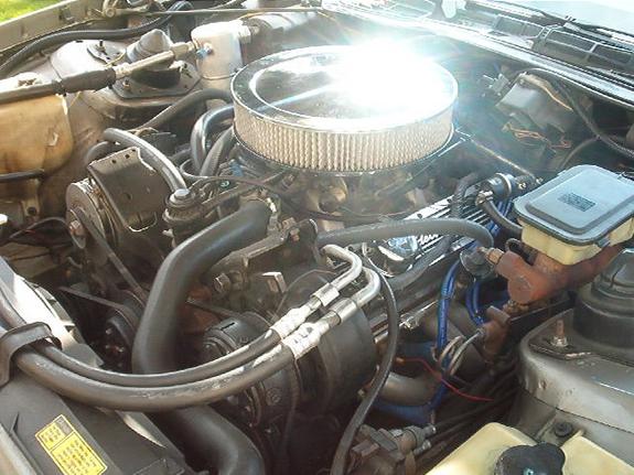

ok this monday im deleting my A/C and i need to figure out what pulley is directly UNDER by A/C pulley? and if anyone knows once i get rid of that pulley what size belt do i need for the "unkown pulley" to the (water pump???) no clue wat that pulley is either....heres a pic of wat im talking about

the power steering pump is under the a/c... not sure what size belt you would need though, good luck

You should be able to just get rid of the AC belt altogether...the PS pump underneath is driven by two belts (the AC being one of them).

The A/C compressor pulley has a clutch that disengages so that the compressor isn't driven when the A/C is off.
