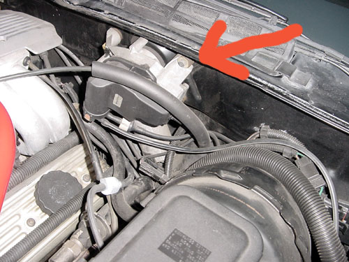

I had just gone out to try and peek past those damned heads but there are just too many wires and such. Question for you guys, what is that in the picture? (the part I have the arrow pointing to) I may be able to see it if I can take that off.
What is it and how hard would it be?

Wiper motor. 305s and 350s use the same balancers, there's absolutely no way to tell from looking at them. Get the casting numbers, or pull the heads.
