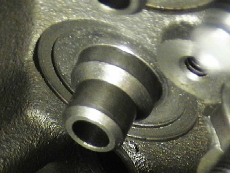

Here is the guide area.

The seal
As you see, it will take allot of stretching to get it over the guide boss.

The spring
Does not fit over the lower taper.

Is there a standard tool that will cut post down so that the valve seal area will be 0.531 and also trim the base of the guide?
I have access to an NC shop with a mill but would have to supply tooling to them. Looked throught the stuff Summit sels but didn't see anything to make the seal area the right size.
Or should I investigate having them done by someone who knows? (probably will cost $)
Didn't see this difficulty when I went forward on my project.

comp cams makes the tooling... I was looking into it a little while ago. You'll need an arbor ($20), and the tool for the seals is ~$40, and to cut the spring pocket is another $40.
Check comps website, look under valve seals, it's on that page where the tools are. Then search summit with those part numbers. (or your local speed shop.)
You don't need a spring cup on the bottom- the foot of the guide boss should be machined down enough that the spring and the dampener coil inside it fit over it but are still close enough that it retains the bottom of the spring from the INSIDE of it.
Little 1.25" diameter springs don't walk around too much, anyway. I run them on Iron Eagle heads that have no such foot on the bottom of the guide boss- and I don't use any kind of spring cup or locating device. Yes, they walk around a maybe a little but nothing that has ever caused a problem below 6000 RPMs for many many miles.
