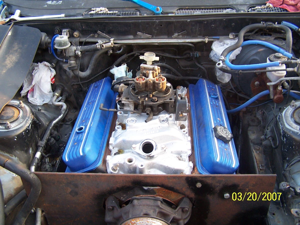

What the crap?
Is that a steel motor plate? That you'll be using long term? You gotta keep the water off that, your waterpump and crank pulley don't look as nice as the rest of the motor anymore

Re: Looking for some head advice
Haha. Yeah steel plate. As long term as it lastes. They don't excatly make coversion engine mounts
The exhuast would get in the way of my other mounts i made, so i figured why not. Yeah nothing is real pretty right now just trying to get it to work.
The exhuast would get in the way of my other mounts i made, so i figured why not. Yeah nothing is real pretty right now just trying to get it to work. Trending Topics
Did you make the motor plate yourself? How?
What's it fastened to? You still have another mount to control back-front engine movement right? As well as the tranny mount for tilt? (forward/back?)
Cool, always wondered how one would go about a swap like this. Link me to your website if you have one, with more pictures of that car. I want to know what it looks like from outside, i'm unfamiliar with that car.
What tranny are you using? Any problems fitting everything in the bay?
It should be a really weird car. Didn't those come with stock turbos in that year? (ie, why bother using a V8 chevy?)
Yeah me and my dad made the plate. 1/4 Plate. The plate is bolted to each frame rail. And bolted to the front of the engine. Yeah fabbed up a tranny crossmember mount. I just have a cardomain site with a lot of write up on the car before the swap. http://www.cardomain.com/ride/609592 Useing a 700R4 cause thats what we had layin around. It actually fits in there kinda nice. Had to beat the tranny tunel just a little to fit it in. Yeah they could have came with turbos factory. Mine was a n/a it was gettin tired 200,000 miles. I could build a high output chevy for what a stock rebuild cost for the yota. And plus i found that someone else did it. So i was like if they could do it I'll try to

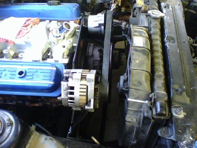

We are working on the alt/ac brackets tonight i'll try to post some updates throughout the week.
http://www.sdsefi.com/features/dec00supra.htm----------
