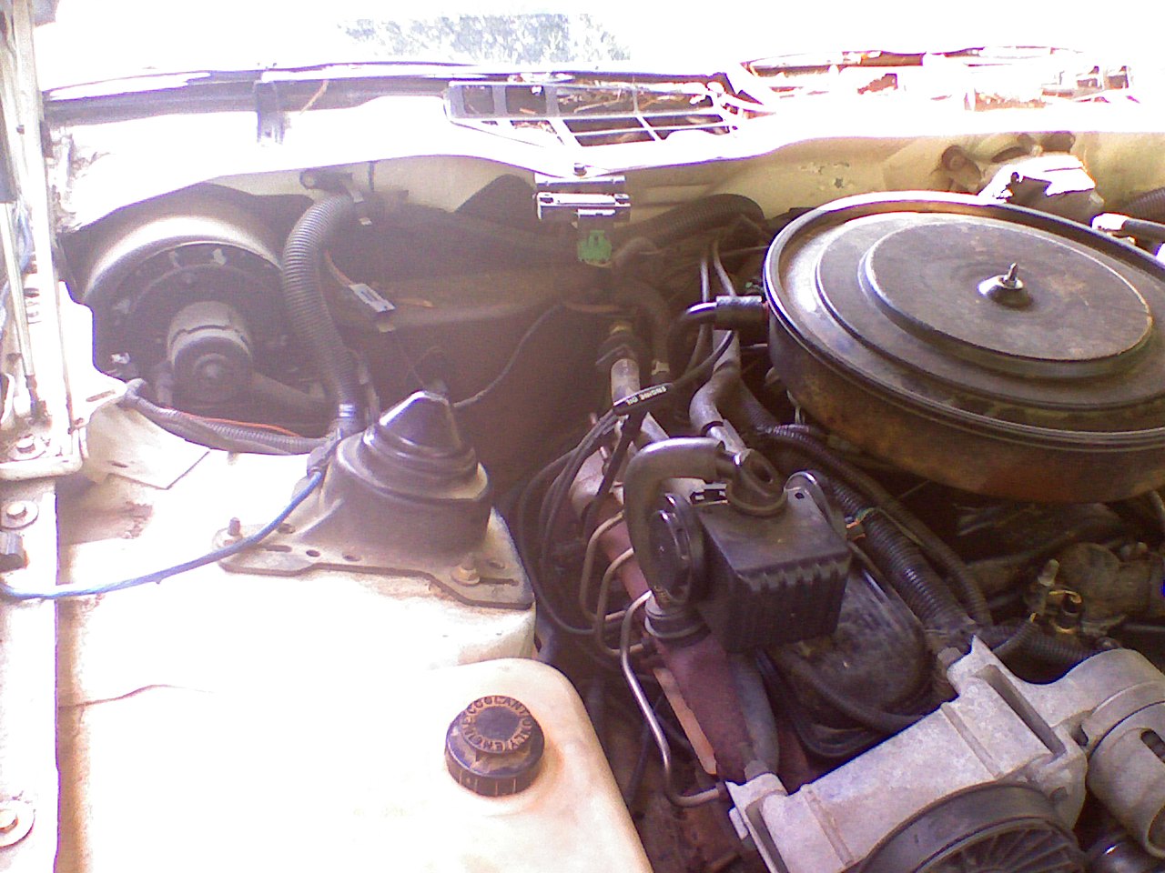

Pic 1 - The part thats on the left side of the engine/carb. I have a hose that looks like a radiator hose but it only comes out of the firewall about 5 in.

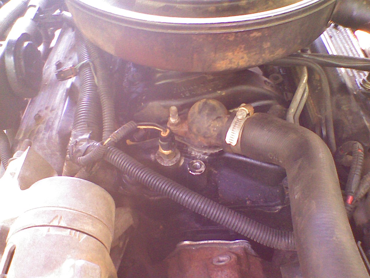

Pic 2 - A part that screws into the empty hole on the engines front?

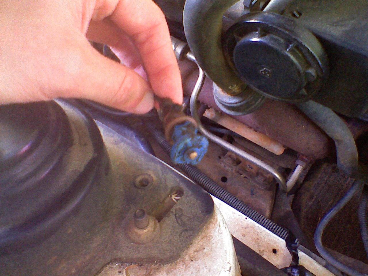

Pic 3 - This wire is taped with the starter wires, but the blue plastic appears to have been melted.

Pic 1 That hose should go to a vacuum actuated diverter valve for the heater core to control heat in the car. There should be 3 hoses that come together at the valve and one vac line.
Pic 2 looks alright except you said this is a 92 RS that water neck looks wrong I have a 91 RS and there were sensors 1 or 2 can't remember( swapped to TPI) which.

Pic 3 looks like it is the fan temp sensor wire. There should be a sensor sticking out betweenthe 6 and 8 cyl on that side of the motor. Its right above the starter and usually is accessed from under the car, that may be what that wire is for.
