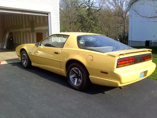

Hi everyone,
I just picked up my sister-in-laws 92 Firebird V6 and I am storing it for her for a few months while she moves to a new house. She parked the car in her garage about 10 years ago and hasn't driven it since. Being such a nice brother in law, I am planning on getting it road worthy for her again so she can drive it on weekends, etc. She bought it new and I know she wishes she could jump in it and go.
Anyways, believe it or not, 10 years later, the car won't start, it just cranks and cranks. I don't think the fuel pump is working. I pressed on the valve on the fuel rail and nothing squirted out, there was a little gas present, but under no pressure. Think it could be something else, or am I heading in the right direction? The fuel gauge is stuck on above full, does the fuel pumps on these things have the float attached to them? Sorry, im not a GM guy so I dont know too much about these cars.
So my next question, I followed the fuel lines and they go up to the top of the tank, I guessing an intank pump? So how do I get to this thing? Is there an access panel on the trunk floor behind the rear seats?
Thanks in advance for your help,
Jeff
