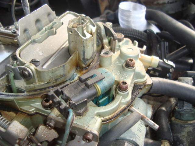

Re: est wire 85 L69 4bbl ?
thats one thing i am unfamiliar with. it has 2 separate wire connectors so i assume it is.
Attachment 217214
Attachment 217215
That is a computer carb. The connector on top is the mixture control solenoid, and the one on the front is the throttle position sensor.
