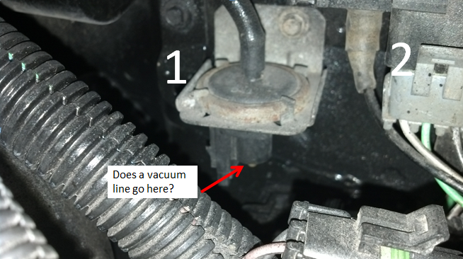

Which one is which?
Hey everyone. Which part in the picture is the Vacuum sensor?
And does a vacuum line go where the arrow is pointing?

part #1 looks like the vacuum switch for the torque converter clutch, Part #2 looks like the MAP sensor (the one you are asking about), and no, nothing goes where the arrow is pointing.
