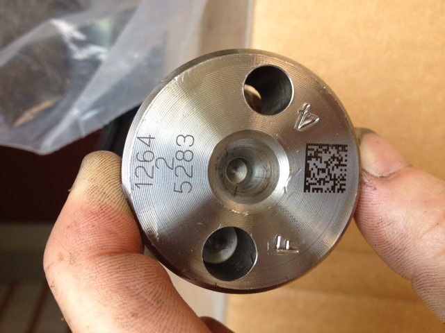

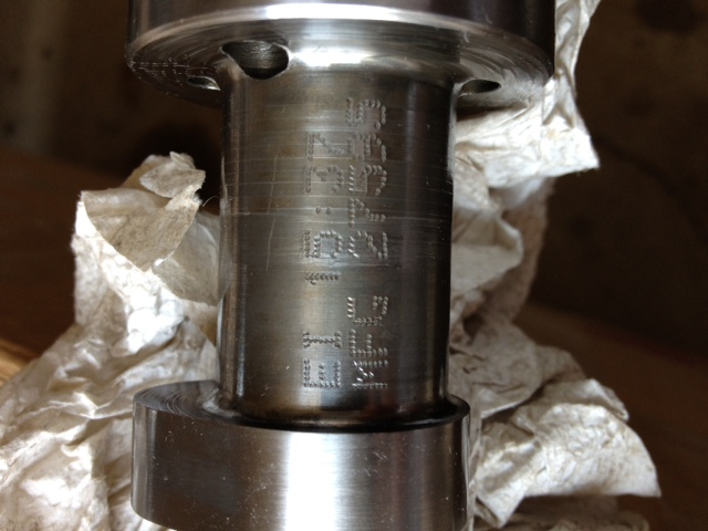

okay,I still need help with this same issue..I'm looking into possible internal issues now.I was thinking that the only two things that I changed when I put the crate motor in was I deleted the EGR and removed all the stuff with it including the A.I.R tubes and the egr relay or valve-whatever that thing called that the vacuum lines are connected to..haha .I have checked for vacuum leaks vigorously and replaced lines and blocked off all unnecessary vacuum ports.
I say all that to say the second difference is I used the cam that come with the crate engine.The motor is an 87-93 5.0L 8cyl according to the tag that come with it.I don't know if the cam is a tbi cam or if there is even a difference.When I run the numbers on the block it come back to be a later model vortec engine,probably a truck one but I don't know.I cant find any info on the freaking cam though that makes sense to me anyway as compared to a stock tpi cam.I will post a couple pix of the numbers on the cam that come in the short block that and see if you guys maybe can help me out...if all it is is the cam thats an easy fix though I'll hate myself for not changing it out on the rebuild...Thanks for any help guys
