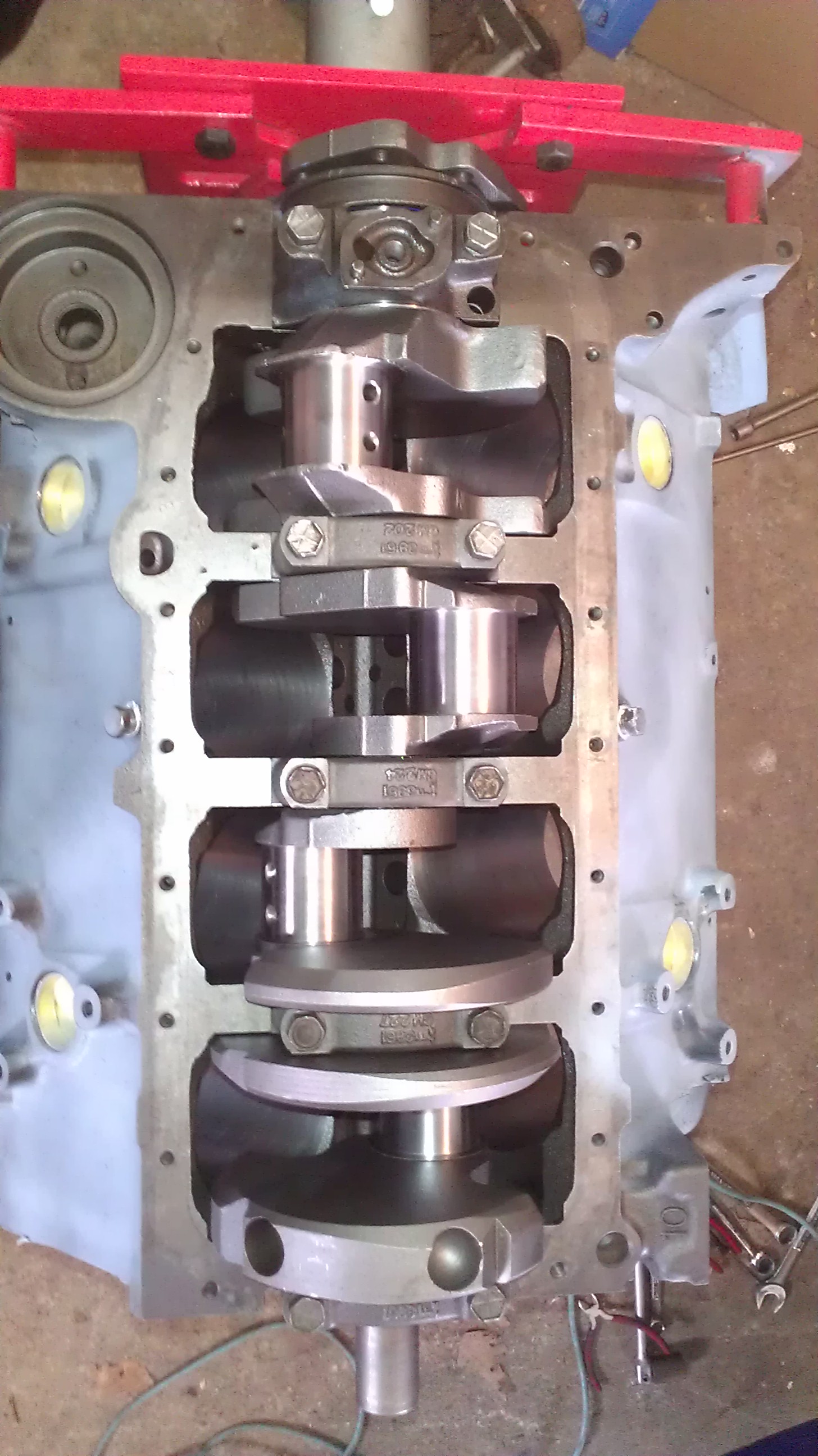

I have a 69 327 block and have a 153 tooth flywheel on it, so I need the smaller starter. Looking at the block, it looks like it will take either the straight or staggered starter, is this right? From what I've read, it originally came with the 168 tooth larger starter with staggered bolt holes. It looks like there is a 3rd hole to mount a starter with the straight bolt pattern though.

Yes it looks like someone drilled it. Rather freshly in fact.
Use a starter for the 12.8" ring gear.

It hasnt been drilled since I had it, I did have it at the machine shop, which is why it looks clean. Would that starter be a 153 tooth count, or do they come in 153 and 168?
Straight bolt pattern starter fits a 153 tooth FW;
Offset (staggered ) bolt pattern fits a 168 tooth

I used this starter on mine
http://www.dbelectrical.com/p-10547-...t-sdr0059.aspx
It is for the 153 tooth flywheel. It weighs a lot less than the oem starter and spins the engine over faster. Great price too!
