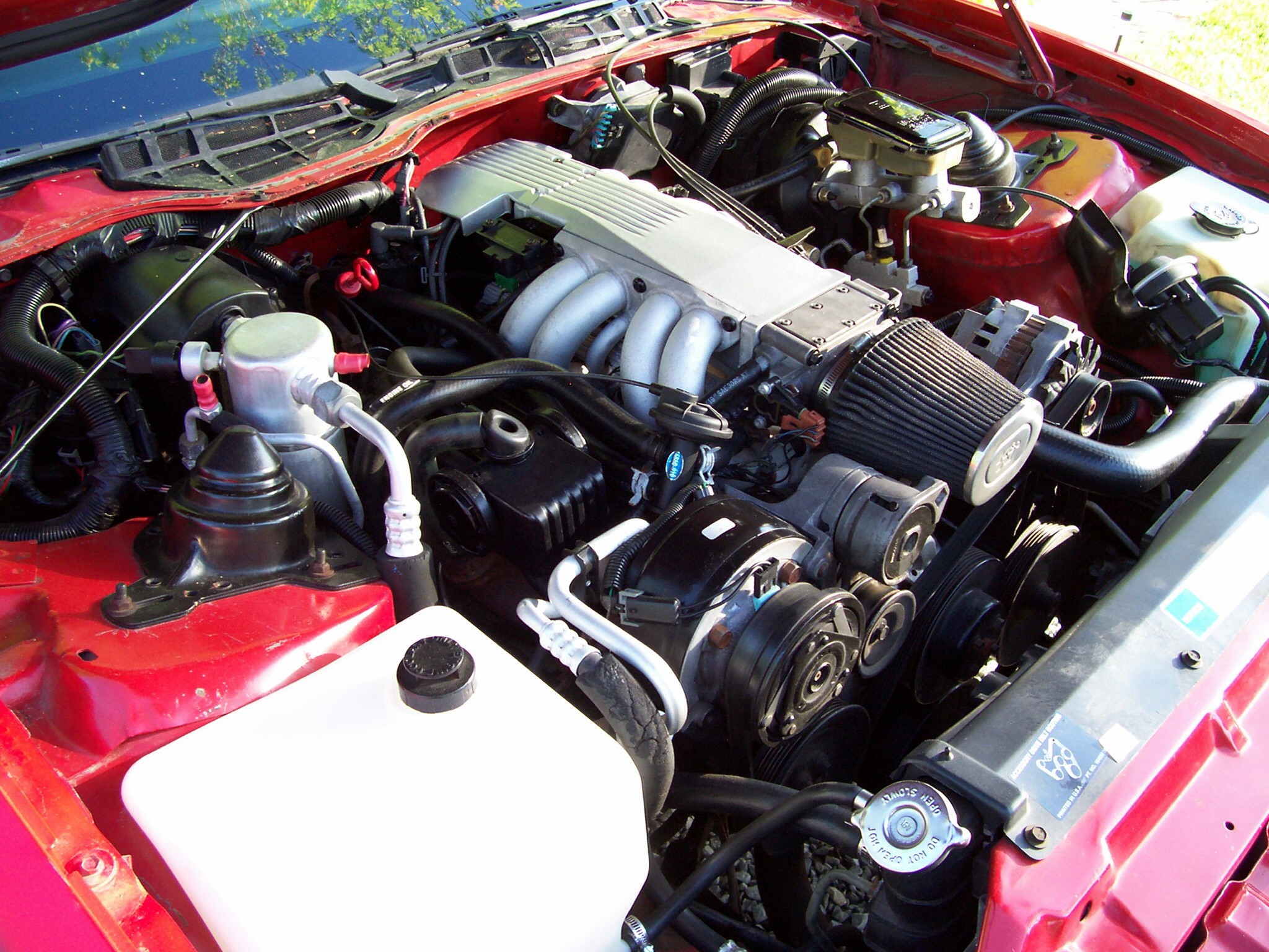

What happens when you remove THESE...
ONE:
See those hoses clamped to the back of the compressor? What happens if you unbolt that? Is it going to spray AC charge and burn my face off or what? I never use the AC in this car, as far as I know it doesn't even work and I don't even know why (don't care). Thinking of putting in a delete pulley, and also want to clean up/de-gunk the bracket and everything that's behind it on the front of the block. Also, will that Schrader valve looking thing on the AC line release the pressure if there is a charge in the line?
TWO: what do you suggest I use to clean up the brackets to make them look new? They are darker grey than they would be new, even if they are cleaned. Is there any polish or cleaner available? I have Mothers metal polish and the green stuff in the garage.

That's a re-man compressor and the system has been updated to 134A.
Just leave it in there, drive the car and enjoy it.

134A is the number of the refrigerant (Freon). It's the newer environment safe stuff. The factory refrigerant was R12.
You can remove the brackets with out removing the AC lines.. Just unbolt the compressor and tie it up and remove the brackets.
If you just want to remove the compressor... It's against fed. law to vent Freon into the air, but if a long wrench just happens to fit on the line and loosens it alittle all of the Freon will come out with a hissing sound.
Just don't inhale the stuff or let it blow on your hand as it can freeze your fingers.
As far as making alum. parts look brighter/better I use a product called white lighting alum. brighter. It's an acid-based cleaner for unpolished, raw alum

If you ever got in a bind and had to sell the car, having all the AC equipment on and intact even if it doesn't work would be more appealing to buyer's over it being hacked off.
If you remove the brackets for cleaning, mag wheel cleaner works pretty well.....

R12 was fine until the patent ran out on it.
Yes, you don't have to remove the compressor from the lines to remove the bracket.
Just unhook the 2 electrical connections and remove the 2 long bolts and 1 short bolt, tilt compressor out of the way.
Buy a factory service manual and read it.
Please don't hack this car up. If you feel you need to hack a car up buy something different and sell this to someone who will take care of it.

I agree on keeping it stock, if you do happen to open the lines make sure it hasn't been running for a while and try to stay on what they call the low side vs. the high pressure side. I think that's what you were referring to in the original post. To do it right I would get the entire AC delete system especially since the smaller compressor doesn't take up much space anyway. If you call around some shops may remove it at a nominal cost since there is the possibility of them reusing the freon.
As far as the brackets go, they are aluminium and should grind/polish up really well. That said, polished aluminium needs to be freshened up every once in a while so that may not be your best option. What I would do is smooth out the metal, and then look into low temperature powder coating in greyish aluminium or maybe black. These brackets do tend to crack so check for that (and the cracking is also the reason for low temp powder coating). It's tempting to try some unique color but along with removing the compressor there is a high risk of it looking like any other trailer park special. I personally would be more interested in preparing them for easy cleaning than drawing attention to them.
FWIW, I forget if it was an allen or torx bolt but on that I would pick up a high quality socket, make sure the bolt is clean, and tap it in with a hammer so it's well seated. I had the fortune of having one break off inside of the bolt.

You can take the A/C compressor off without disconnecting the line. Get some straps or bungee cords and hook it to the holes in the fender rails. I do it all the time when I pull my engine out. This way I can save the freon.

Here's a little something that I believe pertains to this thread.
I took my car down to a shop that evacuated the a/c system for $20.00.
Then I removed what I could and plugged the holes of the remaining lines.
Any way I hated the way that bypass pulley looked. Maybe if I painted the bracket black but the hole thing screamed "cheep junk" and that's what it is. Out of the box it even started to eat my belt. You can see it in the first photos.
I ended putting the compressor back on as the pulley. I can get to the plugs easy enough now, but how bad does it look ? The compressor with out the piping that is. The first photos are embarrassingly nasty but that has been fixed.
Here's a few photos.
The last photo is how it looks to day =
