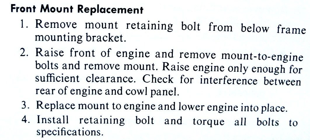

Re: Lifting the engine from underneath?
The Shop Manual Makes It Sound So Easy

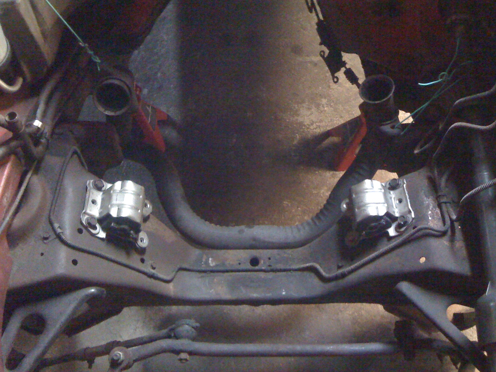

tack welding the nuts on is a great idea.
i've cut the bolts off with a zip-wheel and stitch welded the mounts in a few times. it's almost easier to cut a few stitch welds off than fart around with those through bolts.
personally, i've always chained motors down on the drivers side, (torque side, in forward gears). no broken mounts to worry about.

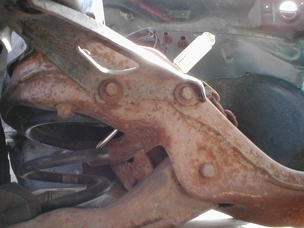

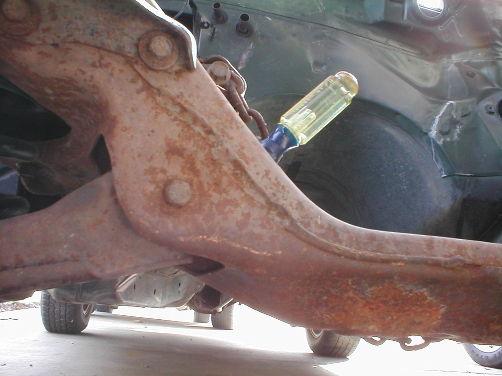

I seriously can't believe this thread is still going.
I'll say it again, it's EASY. If you cant get at the nuts through the existing ginormous holes, you probably shouldn't be working on a car.
