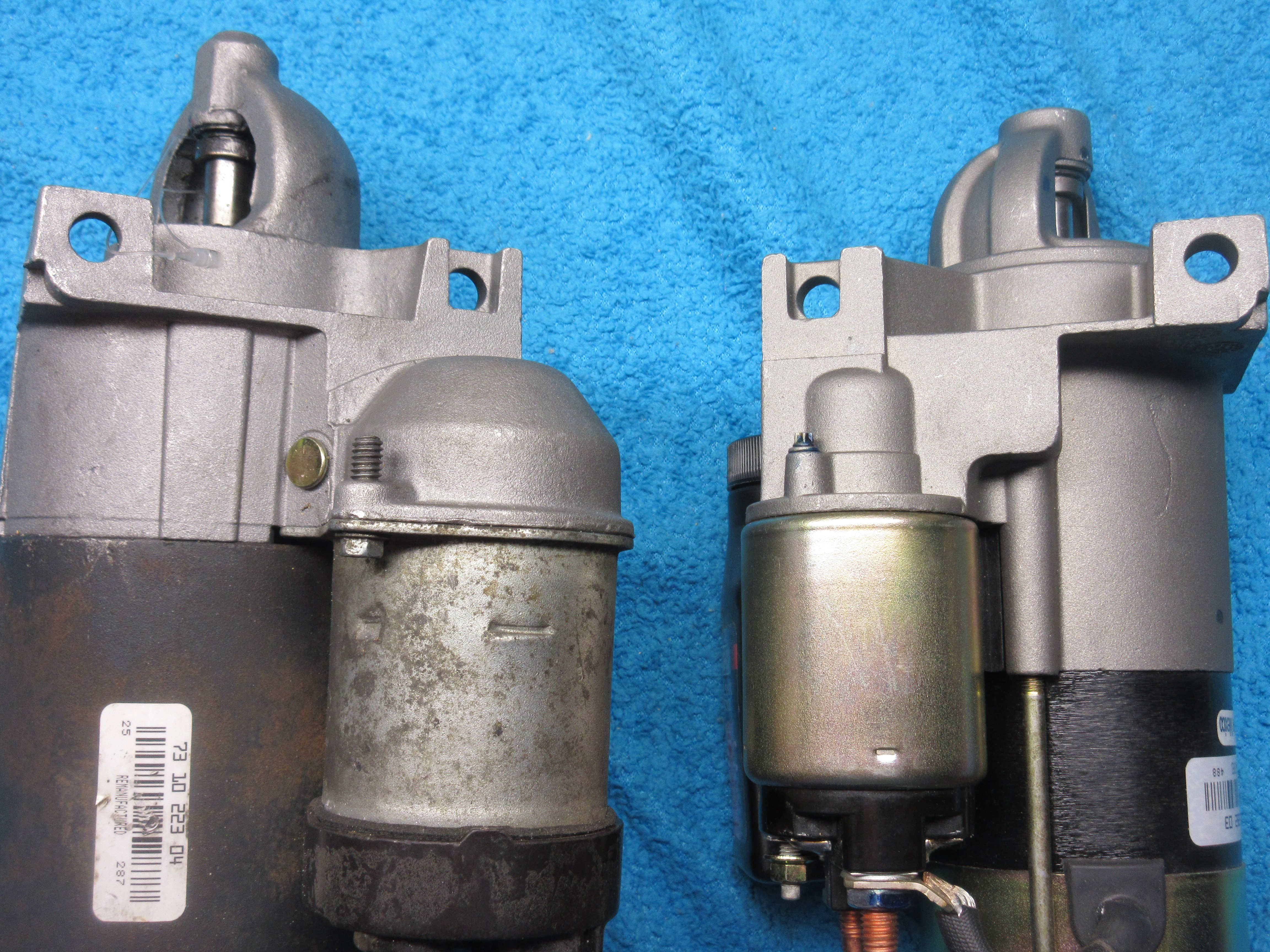

Please take a look at this picture - attached.
Left: Starter removed from IROC
Right: LT-1 starter I just purchased.
Is there a mini starter to match the Starter removed?

The starter on the right definitely will not work.
Maybe the wrong starter got put in the right box???
There are smaller starters available, I just can't come up with the correct numbers right now.

The starter you removed (the one on the left) looks like it came out of a 60-degree V6 (2.8/3.1).
Weird.

Yup, the one on the left didn't come off of a small block Chevy. It would go RIGHT DIRECTLY THROUGH THE MIDDLE OF the oil filter.
Post a photo of the motor in question.

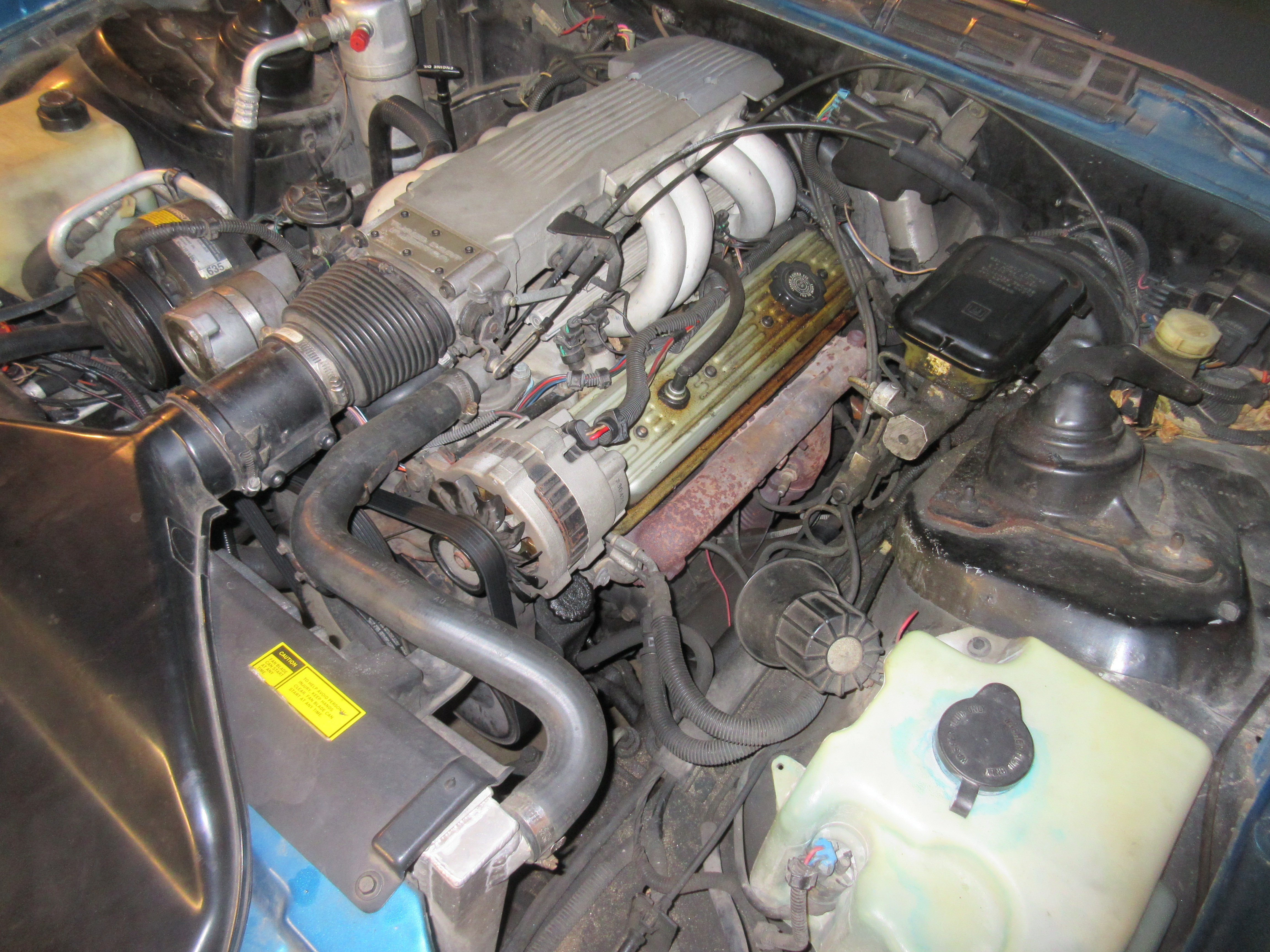

Here are 3 pics of the engine.
350, but block is not original.
I was told it was a truck block.

Yep, that is a SBC. Can even see the starter on the passenger side. The left side starter shown in post #5 did not come off that engine.

The left starter DID come out of this engine.
I removed it myself.
The starter for the '96 LT-1 is the pic on the right.
Any other notions out there?

I am subscribing to see the whiz bang adapter that allows a 153 tooth starter to bolt up to a block only drilled for the 168.
'Cause that's the only way I can see the starter on the left fitting and meshing with the flywheel ring gear, since the pinion cone housing would block the teeth from meshing otherwise.

Gulp... here goes guys ... I GOOFED UP!
I created the whole puzzle by comparing the LT-1 starter
I purchased with the starter I thought I had removed
from the IROC last year. I had it boxed and marked that way.
BUT, with all the questioning from you folks, I boosted up the IROC to take
a look at the current starter. You guys were correct all along!
It matches the stock 350 starter, NOT the one I had pictured.
Sorry from the trouble. My mistake completely.
