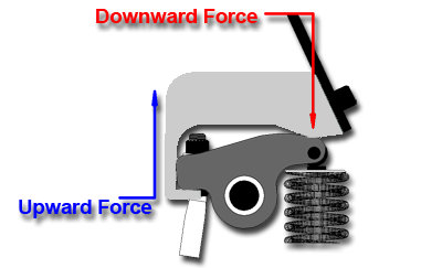

Or the truth may come out:
I have the Comp short travel lifter. Now this update from Comp. Although I may not be in the following descriptor, I certainly am in the extreme use category.
Certain engines respond better to a light lifter pre-load because it recovers more quickly from any bad harmonics in the valve train. Others work better with a heavy pre-load because oil volume is reduced under the plunger, which increases lifter stiffness. COMP Cams® Short Travel Hydraulic Roller Lifters let you have the advantages of both light pre-load and reduced oil volume, producing the most stable and highest-revving hydraulic lifter available. COMP® now offers an XD version of these lifters that features a heavy-duty tool steel pushrod seat. This adds strength and durability in Xtreme Duty applications such as turbo drag cars and offshore powerboats.
This kind of **** pisses me off. I buy the part so as to beat the **** out of them only to find that they're not designed for for a **** kicking application.
Damn!
If I survive past the valve spring testing, it points to the lifter and that makes sense from a historical perspective. The 26918 spring has never failed me but the short travel lifters are a new endeavor.
Time will tell.

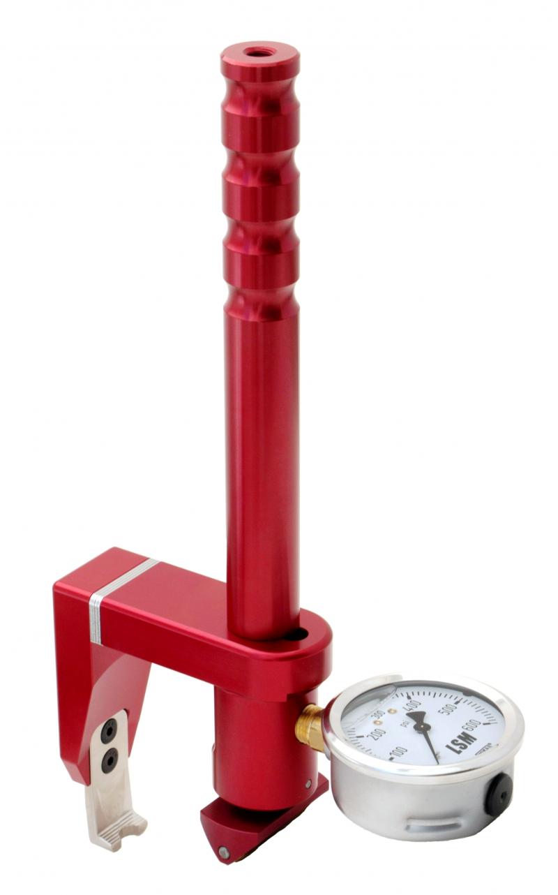

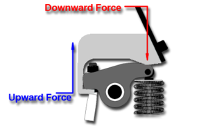

You can use the lever type of on-the-head valve spring removal tool to "feel" for weak springs. It does not have a gauge - you will just have gauge by feel. Just find some means of covering the "C" opening so that you push down on the valve stem and cannot pop the retainer free - dropping a valve. If you want more precise, they do make on-the-head valve spring testers. Or you might find a way of rigging up something like in the 2nd pic.
Attached Thumbnails Mechanical, Electrical? Odd High RPM Noises. (Conclusion?)-lsm-pc100.jpg   Mechanical, Electrical? Odd High RPM Noises. (Conclusion?)-rocker_force_dia.png

Hmm. I do have an on the head spring removal tool...
