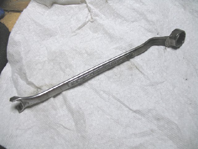

Heck yes, offset wrenches! Before special plug tools hit the market, I found this broken offset wrench in my father's roll-away. A bit of heat-and-beat and some sparks yielded this:
I have a few other specialized tools that I purchased for the job but I've found the wrench the most efficient.

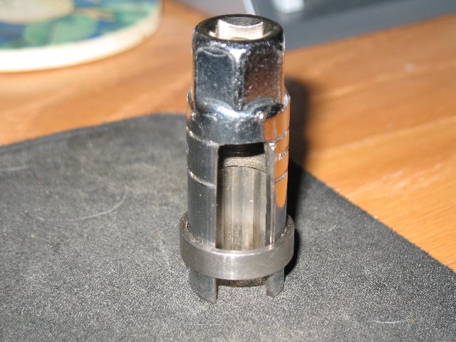

I got tired of waiting for SLP to send me the spark plug socket when I ordered my Tri-Y headers way back when (was supposed to be included with the header installation kit)
The first attempt at a modified spark plug socket yielded this. I had to machine the sliding ring to keep the socket from spreading under torque. It works but it's a two handed job - pardon the expression.
