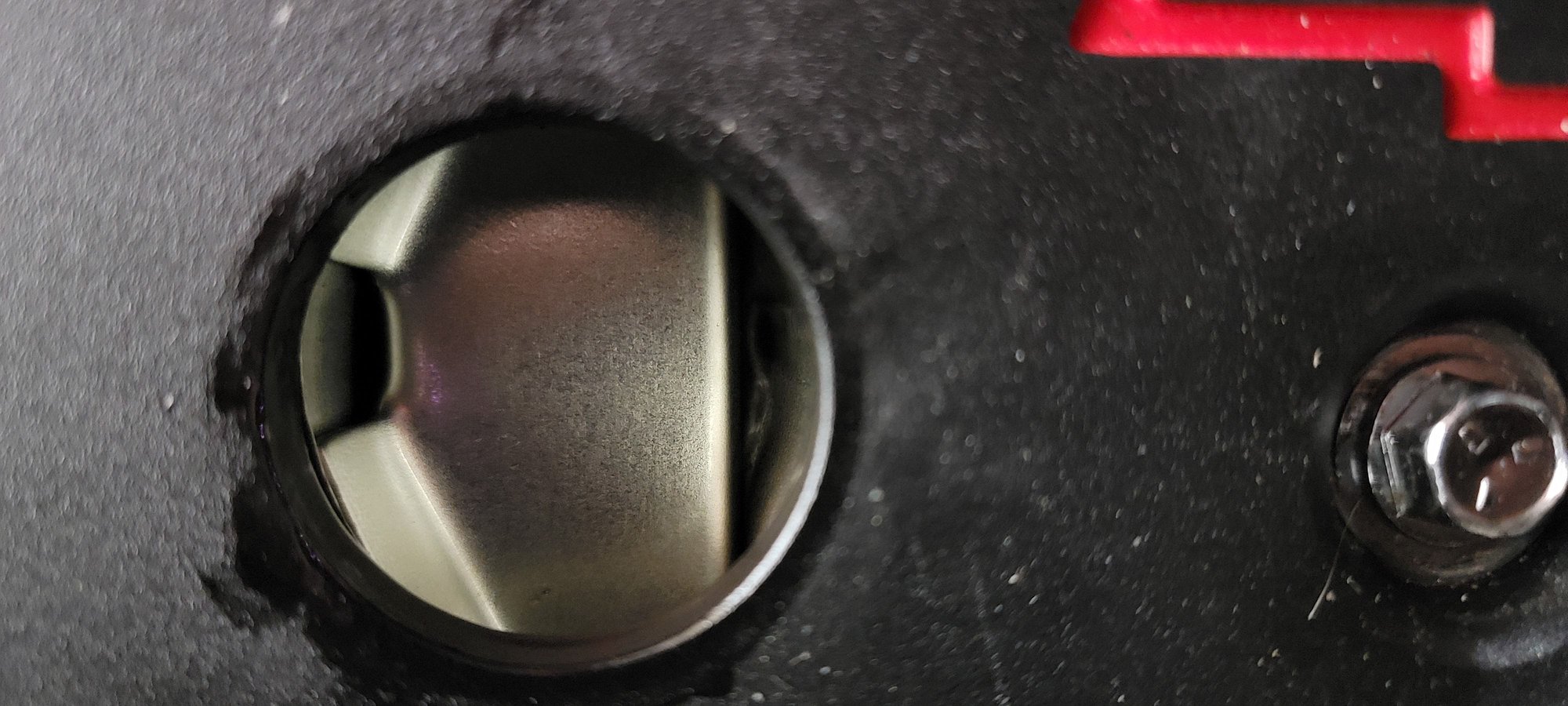

Do you have any pictures of the inside of the valve cover and baffle?
I run the same valve covers I think. Proform GM licensed centre bolt style.
I also run a Moroso catch can located on the rad support.
At most I get an ounce or so of milkshake after hours of run time. WOT. Cruise. Idle. And this is with a thoroughly worn out 355. Carbed too.
Baffles look to be top shelf. Not like some of the aforementioned crap that out there.
FWIW, the crankcase ventilation path is: Passenger side valve cover breather, drivers side PCV valve (which finding the correct one is largely hit and miss with my cam spec and resulting engine vacuum), 3/8" hose to catch can, catch can, return hose to intake manifold port at carb base.
Seems to work OK. Even with the excessive blow-by this tired old lump had.
My cover is identical to yours. Thanks for posting. I was trying to remember what the baffle looked like. Literally full can of oil. And it looked like fairly clean oil. Could be the cheap Fram PCV. Who knows. It seems very weak. I have a Delco and AFR one on the way. It ran great though when it was all hooked up back to stock. I figured if I was hauling that much oil into the plenum, it would have been drenched. Bone dry

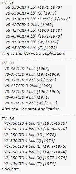

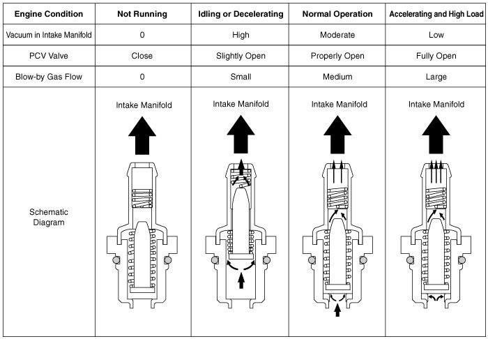

I'm not sure how the valve itself will play out in your application although I did find a very wide variety in what's out there. Because of my low vacuum, I looked to the muscle car era to see what was on those engines. Interestingly, there was also some crossover into the smog engines of the 70's/80's.
I also learned how the valve actually operates. While that may be old news to you, it got me to thinking further into how the system works as a whole.
It also lends some cred to the adjustable valves that are available.

I have the FB 184...I think. Fram. I think it's to weak. At wide open throttle with lots of oil splash I'm thinking it may be offsetting way to easy but I don't know. I'll see what happens when that AFR valve gets here.

Originally Posted by F-BIRD'88
Does anybody make a PCV valve that has a clear plastic case . So you could observe the action of the internal pindle valve and see if oil is being sucked in.
Old 60's era Ford and Chrysler PCV valves were steel case and screwed together. You could take them apart for cleaning and service.
Allows teeeking the action and flow in various modes.
None that I'm aware of although that is an interesting idea.
