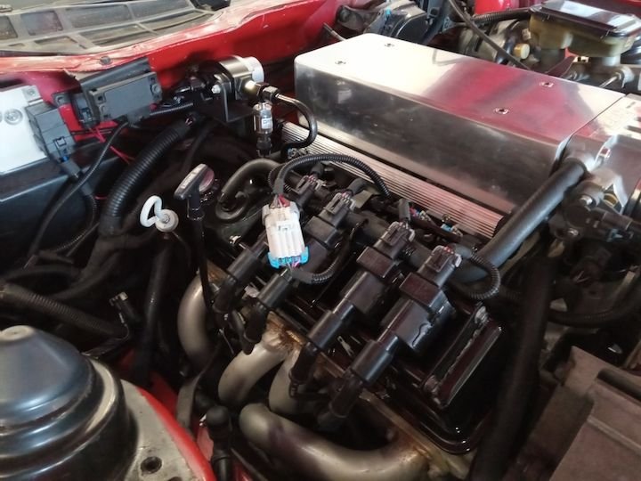

The HP software supports with the right configuration. I used Holley's cam sensor, which drops in the distributor hole and also runs the oil pump. So directly replaces the dual sync, but has a much more durable sensor.
Used a 36-1 crank trigger, and spliced both that and the cam signal into the existing harness. The crank trigger is supposed to be for "off-road use only", which is a cute way of saying that they can't help you and won't support mounting it with accessories. The damper snout has to be shortened to keep the crank pulley in line with the rest of the accessory drive, but it's doable. Also have to make sure that you can still center the pulley since the centering lip will now be pulled away from the damper.
Purchased some used LS coils (D514A style) off Ebay and fabbed a valve-cover mounts for the coils. Those came with the 4-to-1 harness, so just had to run two power wires to the coils via relay, ground on the heads, and run signal wires back to the ECU.
Here's what I did for the covers (was the most simple way I could come up with).Three brackets with two long bolts going through all four coils.
Looks like you're running a Procharger, so one word of caution. I'm working on my D1SC install now, and not sure how the air filter is ever going to fit with tall valve covers and coils on top. May be major clearance issues for you, but could really mount the coils anywhere close.
Thanks for all the info, something to look into. As i am running the Terminator X ecu system will have to work my wiring out for that.
Then crank sensor etc.
Yeah would have to find somewhere different for coils to mount because of the higher valve covers and ProCharger filter etc.

Yeah likely not going to work with that filter setup. Maybe you could mount coils on those support bars that go across the strut towers.
