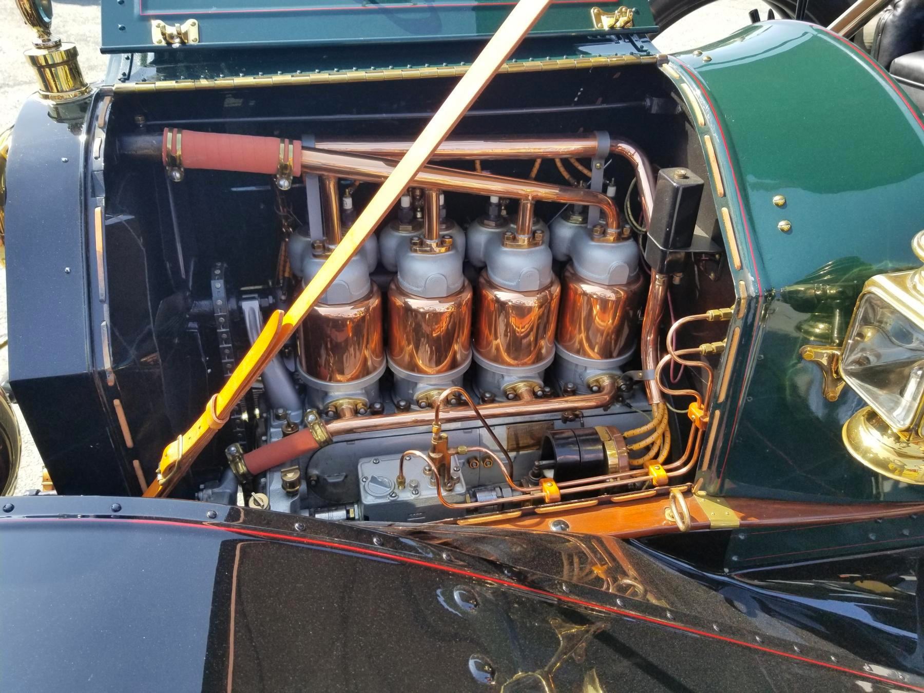

'10 Cadillac engine. Copper is for the water jackets around the cylinders. First 4 cylinder engine w/5 main bearings. The Hupp has 3, the Hudson only has 2!...
A different '10 Caddy. Note the carb, waaaaayy down below that copper manifold extension. Fuel delivery = gravity feed, so carb needs to be LOW down.
