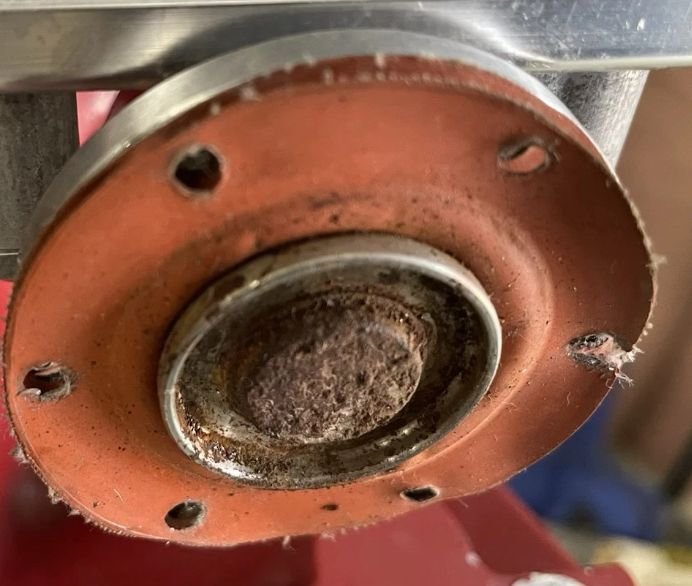

If it’s the **** style regulator, this is the response Holley sent me a few years ago
I was able to find an internal part number for the diaphragm assembly. Part number 35R1998A. This is not a retail part number
this is the same kit i have its old but been stored. Im sure they dont sell a replacement diaphragm. Just like they dont sell the magnetic pick up coil on the msd distribuitor since holley and msd are parent company's now.

That’s the part number I provided. Call Holley and give the engineering part number.
84661 msd. ?

A stock regulator can be made to work 😆

https://ebay.us/m/4z3nXM
cheap to buy and easy to modify
