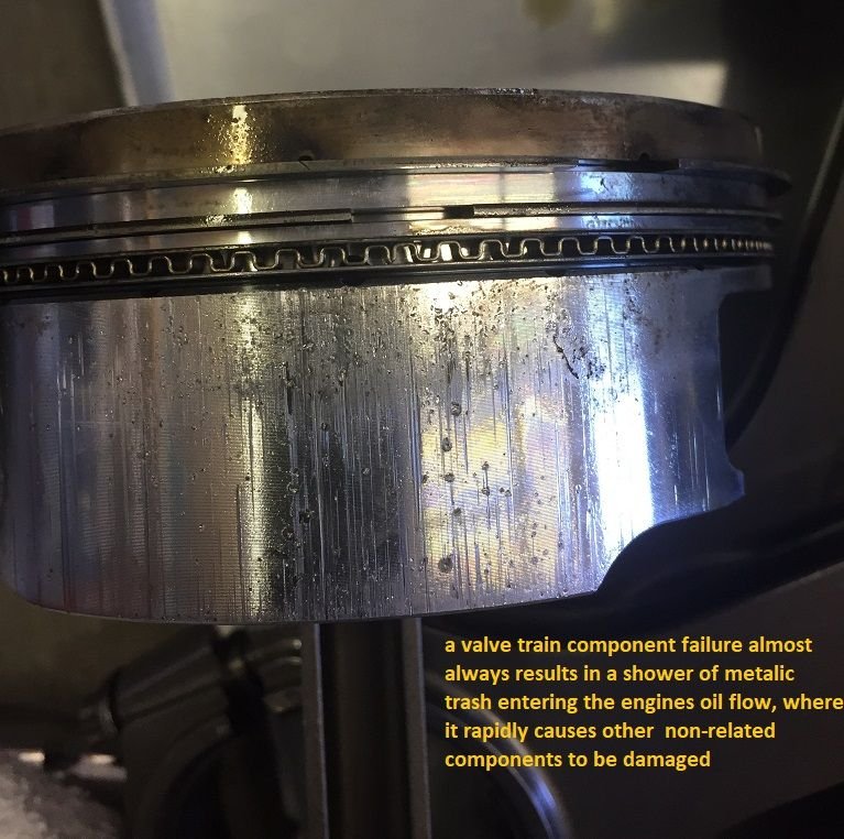

Been there - done that.
What was your valve spring setup? Did you measure all the valvetrain clearances - retainer to seal, coil bind, piston to valve?
DON'T run this engine any more. That "glitter" is hardened cast iron shrapnel and your oiling system has distributed it throughout the entire engine -
the oil pump, ALL the bearings, the cylinder walls and piston skirts, inside the lifters - EVERYWHERE! You have to clean it out completely before
you start over. And NO, the oil filter didn't trap it all for you.

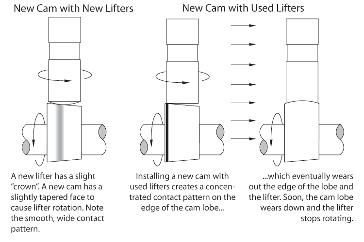

Did you reuse your old lifters with that Howards cam, or new everything?
Old May 7, 2026 | 10:46 AM
Posts: 28,022
Likes: 2,496
Re: Valve train tick/loose rocker after rebuild
Good point: those look like they're MUCH more experienced than only a break-in run.

A "flat tappet" cam lobe isn't flat, and a "flat tappet" (tappet is an old word for "lifter") isn't flat either. The lobe is a few thousandths taller on the side toward the rear of the engine, and the lifter surface is spherical with a radius of about 60". The design intends to create theoretically only a single point of contact between the lobe and the lifter, and for that point to be near the outside circumference of the lifter face, thereby imparting a force to the lifter tending to rotate it. This makes the interface look kinda like a ball or roller bearing. There is NEVER supposed to be ANY "rubbing" kind of action on these surfaces. Of course the metal isn't perfectly hard, and so deforms slightly, such that the interface is more of a line on a radius of the lifter than a point; butt a properly working one produces a sort of "ring" around the lifter surface around 2/3 of the way from the center to the edge and maybe 1/8" wide, and wear on the lobe only on the rearward half of its surface at most.

You're lucky that they all rotate, because using new lifters with a used cam is not supposed to work.
Look at these diagrams. What do you suppose happens to the contact pattern when using a new on a used camshaft lobe?
Answer: NO ROTATION
Look thru here - even if you just look at the pictures: cam wear,articles you need to read | Grumpys Performance Garage
And I'm not trying to discourage you but your pistons might look like this already. You will burn oil if they do.
I think you got that backward. You can put new, flat lifters on an old cam....you CAN'T put old, flat lifters on any cam, except for the same lobe of the same cam, that it came from.

A used camshaft, where the taper is worn and the lobe is now flat, the point of contact will be right at the center of the crown on the new lifter >>> NO ROTATION.
Some have gotten lucky in the past when doing so, but it is a less than ideal situation.

I've heard that you can, unless the cam is worn out, put new lifters on a used one, and then do the rain dance. If the lobe has lost its taper then that would be worn out and probably the reason the lifters would require replacement anyways, problems and symptoms.
It seems to have worked, I have done ~600 miles now. I did an oil change and I had to search to find traces of metal.
As for my pistons they looked almost like that when I put them back in anyways so I am not concerned. It doesn't make any undue noise, oil pressure is 30 psi at idle when warm and 45 when cruising, all the lifters rotate as before. I know it is on borrowed time, and that is okay.
Then in that case, the cam was already doomed with the original lifter on it. NO flat lifter is going to last if it's not rotating. What you're talking about ^there^ is an already failed cam shaft. I was talking about a used cam.
I have put new flat lifters on used flat cams several times, in Chev's Fords and even an AMC....no issues.
