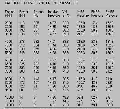

now your dyno table
Attached Thumbnails Someone please run my setup through desktop dyno-table.jpg

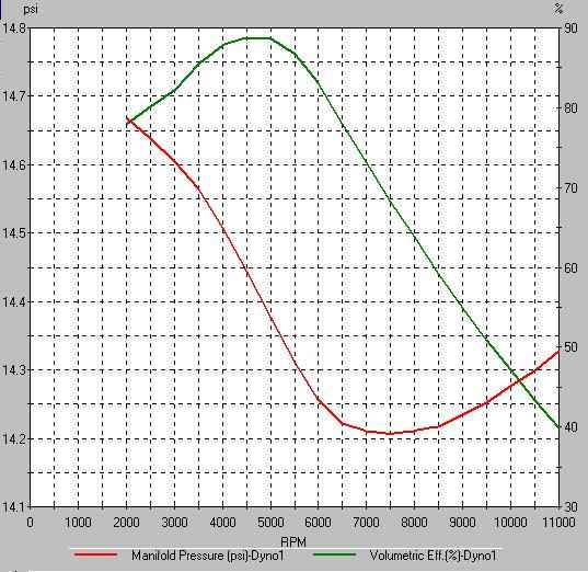

and a g raph to show you your volumetric eff
and manifold pressure
Attached Thumbnails Someone please run my setup through desktop dyno-eff.jpg

350 horsepower...
one of the car mags. did this exact same setup about a year ago, and they only got 275
