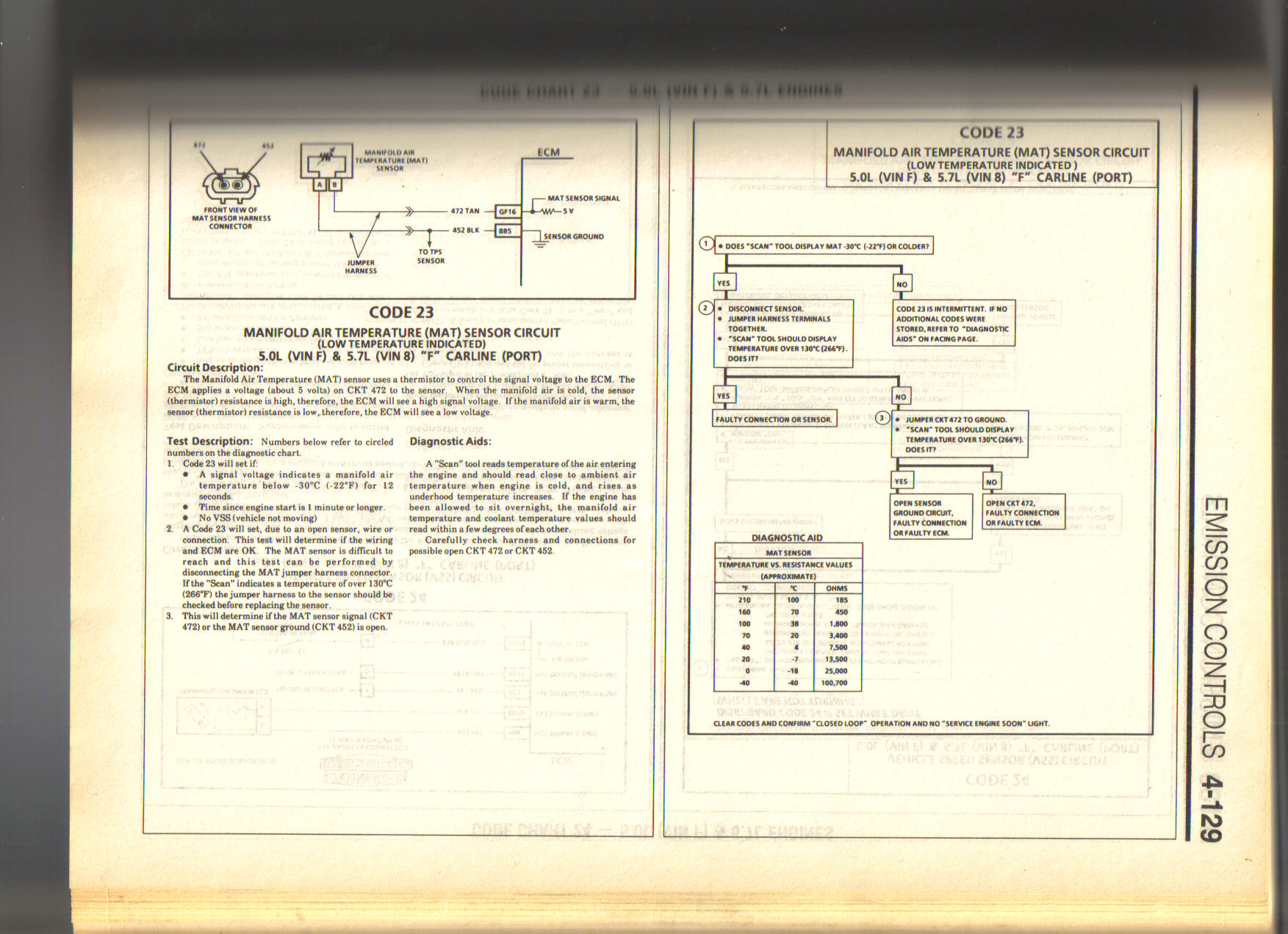

Here's the diagnosing procedure for code 23. Hope this helps.

I notice it says..
"A code 23 will set if: No VSS, vehicle not moving"
Does that mean if my VSS is bad that it could still throw code 23?

I think that in test description 1, those events need to happen before it throws code 23. I dont think it means that your vss is bad. I would start doing the electrical test from the procedure.
