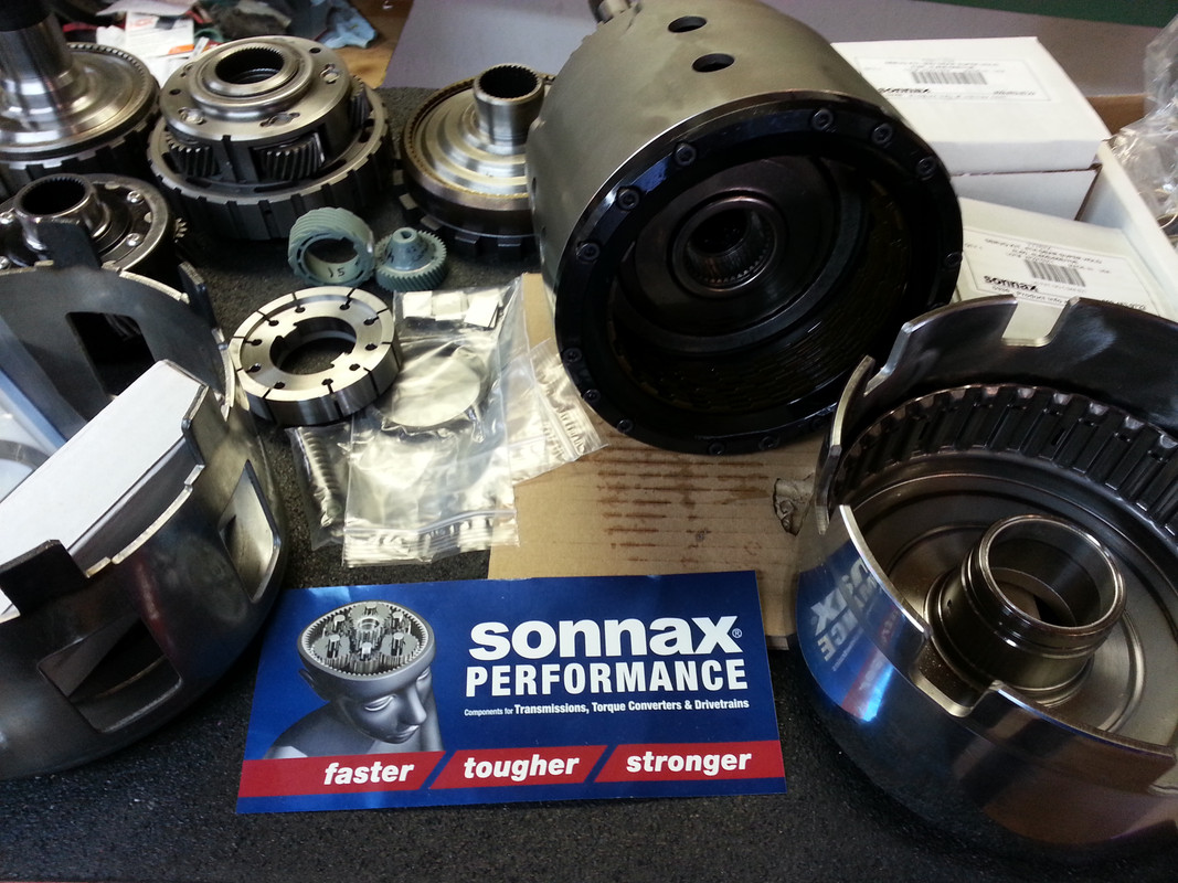

Originally Posted by ASE doc
If you want a Beast sunshell, I have one sitting my box of spare parts. The beast is bulky and heavy, made from thicker material than a sun shell needs to be. I decided not to use it. I rollerized my 700, replacing every thrust washer with a Torrington bearing. For this reason, I used the Sonnax smart shell. It has a Torrington in place of the thrust washer, hardened splines and lugs. It's light like the factory sun shell but strong where it needs to be.
With all roller bearings, I run .005 -.010 end play.
The sonnax unit is the best one out at this time...

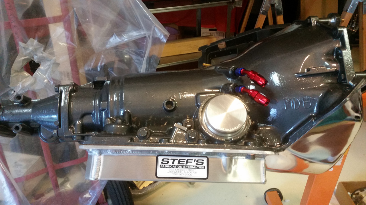

Sweet trans bro.
Nice looking parts stack up. Pretty much identical to mine with the Smart Tech housing and those great servos, except for your 5 pinion rear and that 6 pinion ratio change front. Next time I go into mine, I'm going to the Sonnax HD input shaft, ratio change front and probably the TCI 5 pinion rear. TCI seems to be the only domestic manufacturer still doing the 5 pinion planets for these guys. They are pricey too, $370 for the rear alone, but worth it for the quality, just like Sonnax. I would have used the HD input shaft when I installed the Smart Tech Housing but they weren't doing the shaft then.
