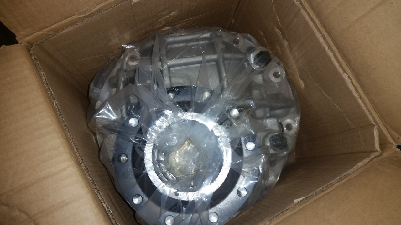

Just ordered a Moser 9" black friday with all the bells and whistles, now I'm in the market for a new center section. Whats the best bang for the buck S case, Yukon nodular , Moser Pro N ? I'm thinking I'm going the detroit locker route. Like to be into a complete center for $1000 or less

Just came in still looking for suggestions

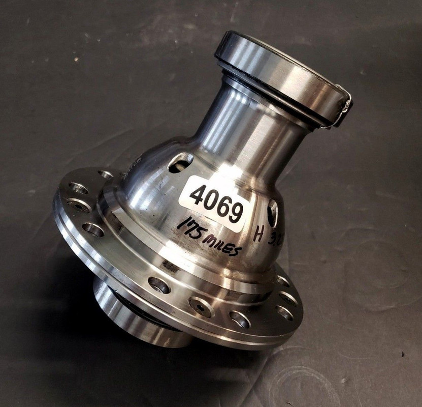

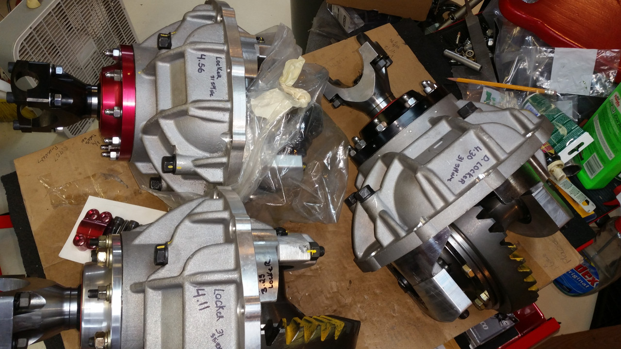

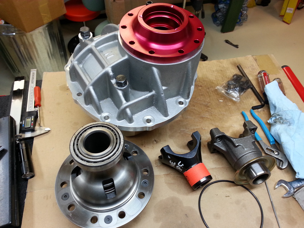

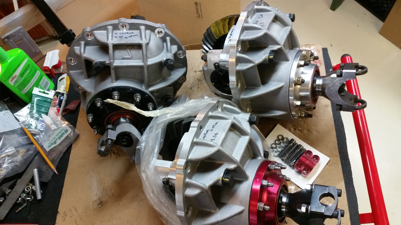

TO save a few bucks build one.. right now A good case runs $360 shipped..comes with a trick Daytona support and bolts..this will be a aluminum housing.. you can go cast iron...But Why??.save 20 LBS and go aluminum..
you can then pick out if you want a Locker.. or what have you... you can get it all done for under $900 and you can do it for about $200 a pop for parts till you have all the parts = $900
.Did all mine from $750 to $900 ea.. with all new parts in ea unit.. I like Lockers so ea one is a locker...I did the larg 3.25 bearings and 1350 u joints with billet yokes... and 31 spline axles... you can do larger axles if you like.. just shop..
the thing you want to remember.. have it put together by somebody that knows what they are doing...
above is a example of a good deal.. $200 to $230 shipped for a like new Detroit Locker with 3.25 bearings for 31 spine axles.
gears $150 to $200 shipped
housing $350
small parts kit $150 (everything you need )
billet yokes $65
ARP pinon nuts $15
(I like the good ricky race stuff so 10 hole shims and goodys $20)
and one other thing.. just looking for good deals.. is ADDICTING! you could end up with more then one unit..
I do have some aluminum housings for sale right now just housing $350... and some kits (you add gears) $775
if your making over 400HP do not use a 5 bolt aluminum pinon support ...they fail!..always use the larger 10 bolt pinon support with the bolt through housings...don't go for the cheap $200 to $280 housing... even the strange aluminum 5 bolt housing AVOID! IT LIKE THE PLAGUE!!
UNLESS you not going to drive the car...then your fine...FYI. (CAST IRON UNITS ARE OK) just don't go over 600HP..

buyIng parts and knowing what you're paying for you can buy the best parts available and build this 9 in carrier for Less the $900 each..You can even spend less.. has I opted for ARP bolts.. just know what you're looking for and if your going to install 1350 U-joints.. by using a combo U-joint you're defeating the purpose of the 1350 U-joint....
