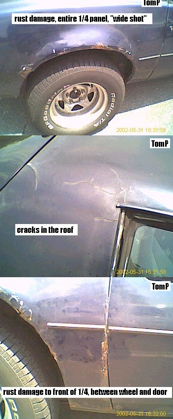

LOL! So you stripped all the filler off the door? How thick was it? If it was a thin layer, the filler is perfectly fine. Poly filler got a bad rep when it first came out, because people layered it over rust and paint, in THICK blobs. And naturally, the filler would fall out. But done with proper prep, and layed down thin, filler is acceptable, and will work as intended.
Interestingly enough, I found out that lead had the same bad reputation when it came out. The resto-junkies all say to use lead, because that's the "right way"- but the same things originally happened to lead (piled up in large lumps + improper prep = falling out). When poly filler came out, and you didn't need a torch, and it was easier to work with, the guys that messed up the lead jobs were messing up the plastic filler jobs even worse- and since you don't need any special tools, the average guy started messing up filler. That's more than you ever cared to know about filler, eh?
