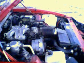

i made my own cai on my car i just have a couple of questions about it. what i did was take that little ram air thing that goes inthe air cleaner offand connected a bendy tube type thing from home depot to the whole it was a perfect fit. anyway i removed my horn and fit the tube down the fender to the fog light whole on the driver side. at the end of the tube i put the middle joint of the orignal ram air thing. it fit in perfect. Now what i wondering is, do i have to much bending going on, i figer when driveing the air goes right in it. could u tell me if this is a ok why on makeing it?
oh and the car is a 84 LC1.

This is my cai/open element...

mike1986fyrbrd you did the exact same thing that i did for a cai. i have the same stock set up all the way until where the square box was. i took that off and put the open element. mine looks the same as yours in the pics

Icebird...good thinking on getting that intake as far away from the engine as ya can..theoretically, down there is a perfect place. But take it from me...(someone who's run stock intake on my car, plus 4 separate homemade setups)...bends, or lack thereof, are just as important as getting cold air in is. I had a system similar to what you described, but I've got a Camaro so it was easier..I routed dryer ducting down and relocated the filter behind the passenger foglight opening. While it did run better than stock, there were so many bends and kinks in the tubing that it was still being restricted. I discovered that once I tried running that stock plastic flexpiece with the conical fitted directly at the end..straight in..made a HUGE difference, BUT when the car heated up it got gradually slower.. It should be better than stock, but you're gonna have to experiment to get something that'll truly work good. I think mike and v6 have the right idea..it doesn't take in the COLDEST air and it doesn't have a ram kind of effect, but it's a good compromise.

ya i thought i did ok for my first try, the only diffrence is that i dont have the fog light the air is goin right in the whole when i drive. i got it fit in there perfect. is that ok?

As I said before, you're getting nice, cold air, just you've probably got a lot of bends in the system. From what I've noticed...cold air will get you to pull harder, but less bends in the system gives you added throttle response. Just gotta fiddle with it and find something ya like. Like I said, I've been through 4 systems.
