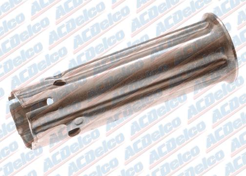

I use the factory metal boots. I never had these for the first couple of years I owned the car. When I bought the car I only had one metal boot on the #1 cylinder and now I have them on all of them. Do you think these help?

I threw all those metal boot protectors out
