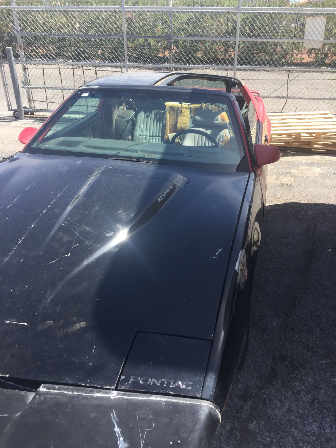

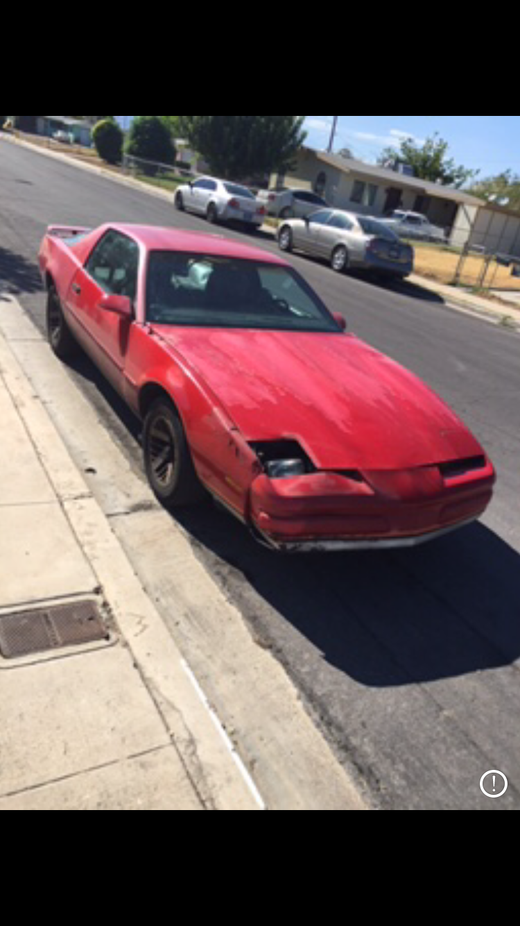

A few months back after my t/a was burnt down I had to have another car. I found a bucket on offer up for 800 bucks. A '6 non t-top and no goodies. Talking back and forth with the guy, he tells me how he can see I am a bird fan, that I know what they are worth. But telling him that it's a base car he went down to six bills. I told him him I just could not do that. That every panel had a dent, non t top, it was a v6, the exhaust was broken off, and the interior was all trashed. Not only this but I proceeded to tell the guy that some one was doing drugs in it and it was not coke. You could tell they were on that blue meth and there was ash everywhere. So we agree on 300 bucks and I took possession of the vehicle. At that time there was no keys.
Fast forward a bit, I really missed my t tops. I found a member here in the forum that was parting out a bird and I bought a trailer full of parts from him. Including the t top. There was none to be had here in Vegas. Not only that but the cars don't change out much here. Sometimes seems like twice a year. The glass I eventually found here over time and when I got the last one it was time to chop the top off. The neighbors thought I was nuts and one came over to lend a hand and watch as it was nothing he had ever seen. I still have clean up work to do on it. But I'll finish another day. I also need to get more pictures.
I decided to get another bumper as this one was trashed as was almost everything else. And hey, I'm saving a third gen. Plus I am and '80s kid. I love watching the show and had all the toys. I have had a few cars(6) and one formula that was converted many years ago that was wrecked that was sold over seas. I miss that car. It was my love, I had so much time into it, I was never the same when it went. And I was always looking for another bird at the right price. At this stage in the game the bumper cost more then the car and insurance.
