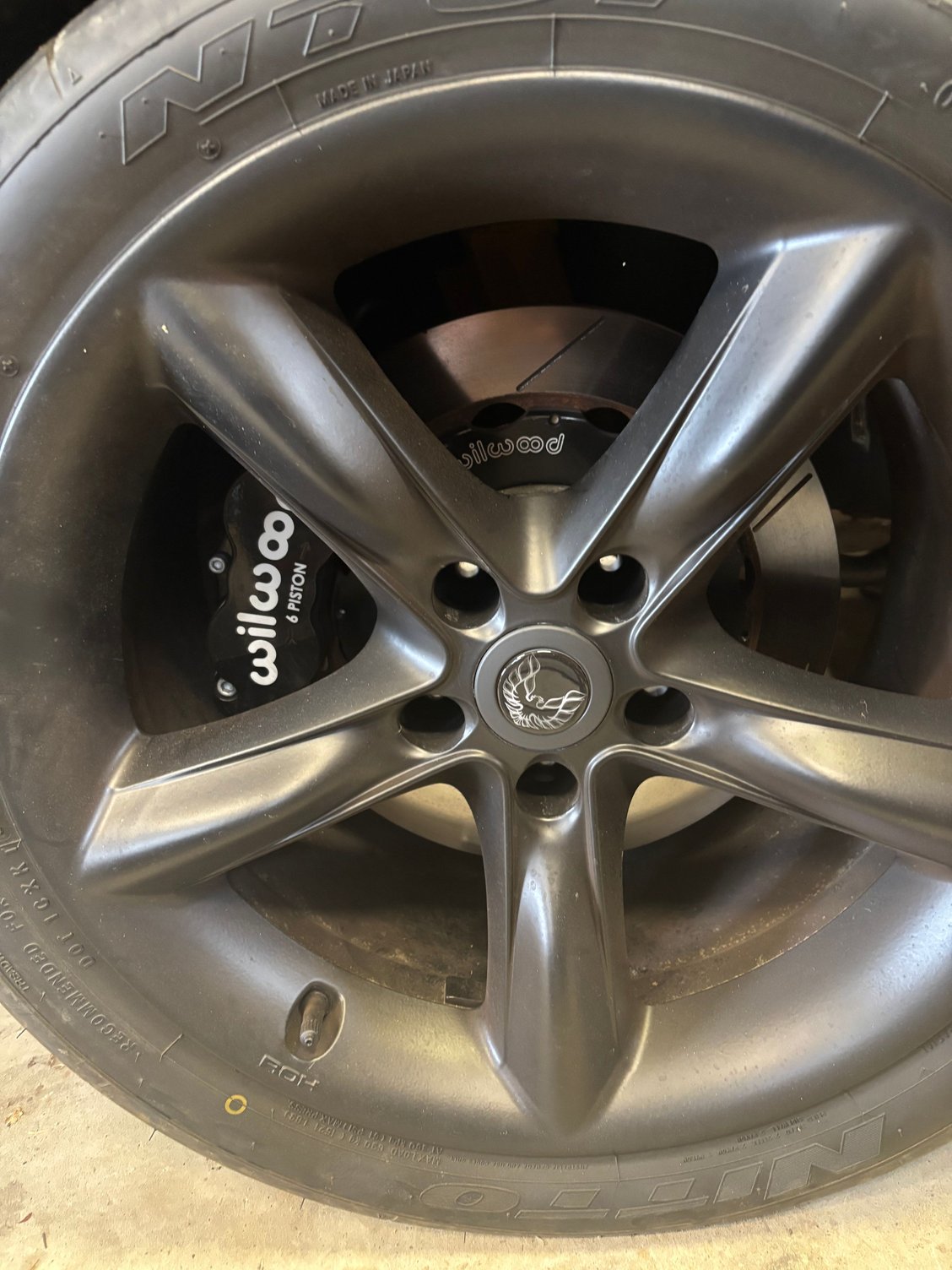

I have rear18x10 w a 6.0 back space and 18x9 w a 5.0 back spare up front. 6 piston 13.5 inch wilwoods.
I really dig the look of your car! Are you using spacers on your wheels?
no spacers.
