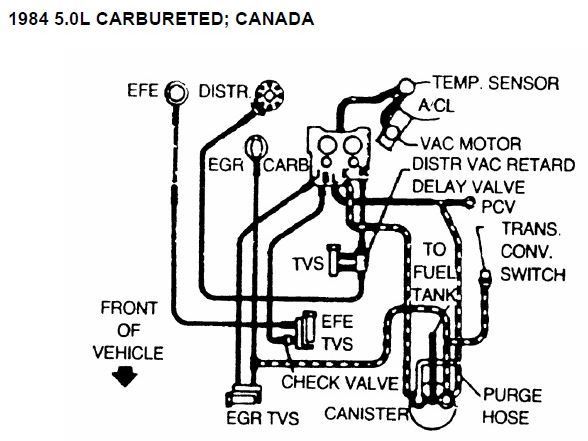

Since nobody on the Canadian forums seems to know, I'll ask here:
Did the non-ECM, carbureted Canadian thirdgens come from the factory with smog pumps?
What about EVAP canister control valves?..?

This might help a little. From this thread: https://www.thirdgen.org/forums/tech...iagrams-i.html
Here is a link for 83 Crossfire: https://www.thirdgen.org/forums/tech...ml#post5077405
