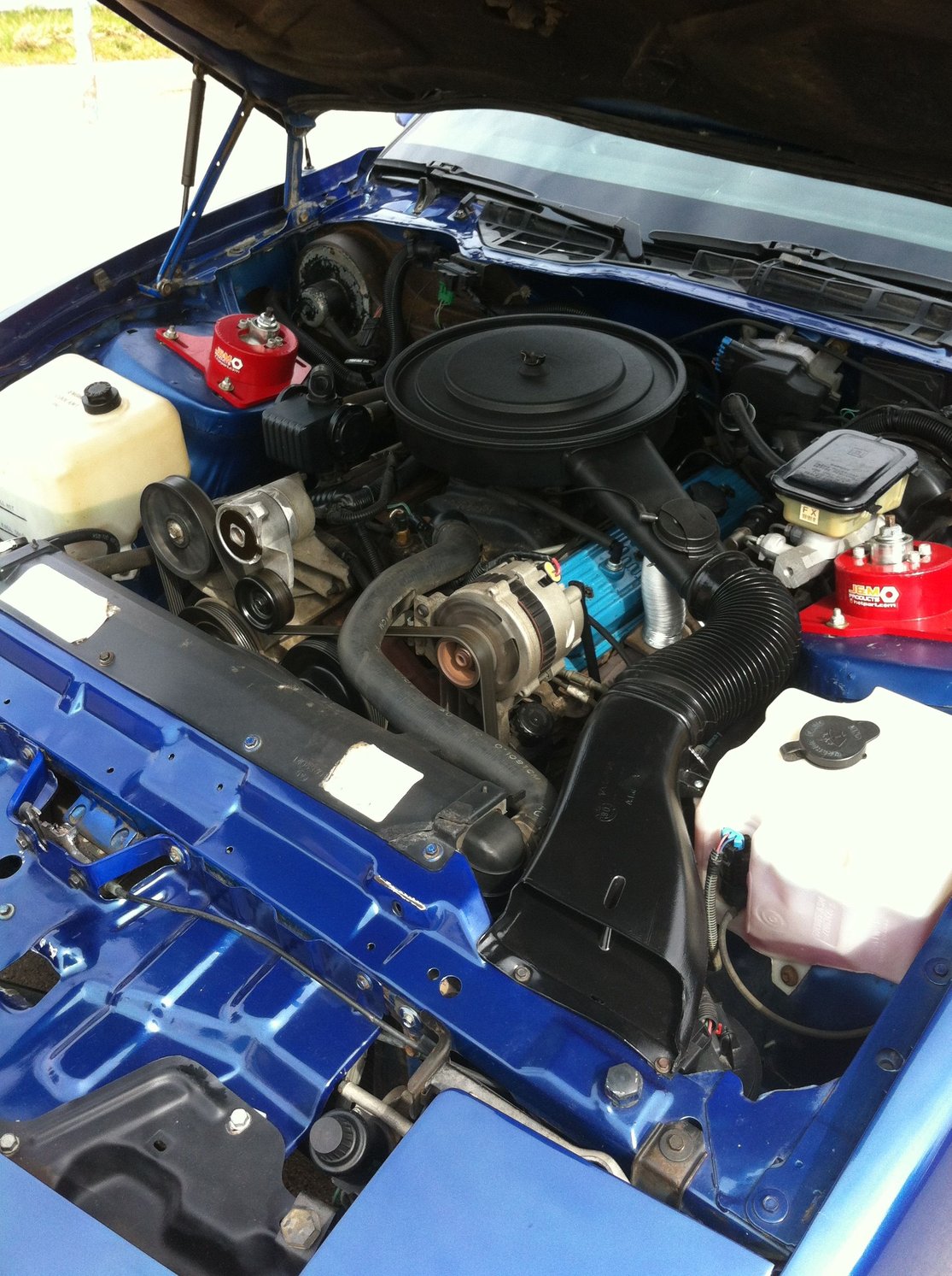

+1 For UMI. I love mine. Look great too.
http://www.ebay.com/itm/Camaro-Fireb...l2GgCw&vxp=mtr
Reply 0
Jun 1, 2017 | 09:43 AM
Re: 'Just Speed' camber plates?
I couldnt be happier with mine either.. Never had a issue with bottoming out.
