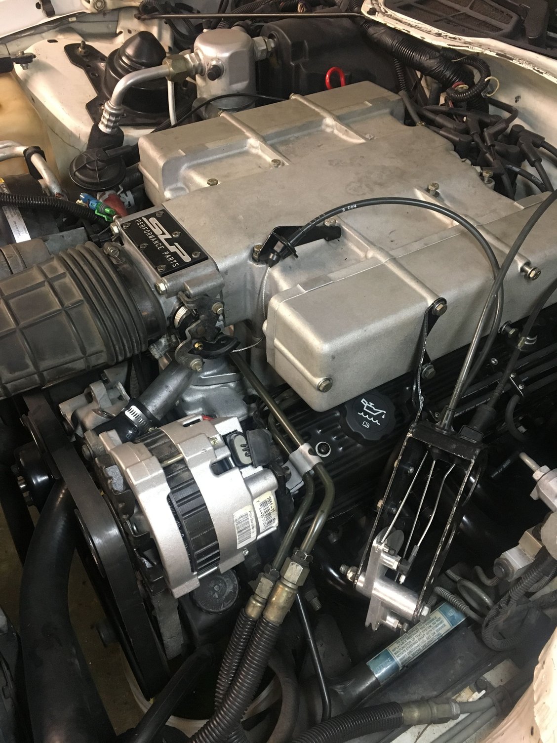

so I made a little progress. Finished the fuel supply and return lines and the mount for them, got the y pipe mounted, o2 in it, oil pressure sending unit back in it, a few odds and ends done. I ordered a C4 gear reduction starter, and I started mocking up the cable contraption. None the less, I’m back working on it!

That may be the best alternative to running the fuel lines on this intake, did you flare the ends your self?

Yes I did, I just use the blue point in-line double flare kit. Works very nice for the money. I just did a standard double inverted flare then the borgeson flare to o ring brass adapters to run the stock soft lines with them.

I suppose there's a reason they didn't just route the stock cruise cable under the "plenum"? From that angle it looks like it'd clear if a person could fab a bracket. But I'm sure if it were that easy they wouldn't have bothered with the funky bellcrank/relay setup.
The fuel lines came out really clean! Nicely done!

The fuel injs are pretty much right in the way iirc

Yeah, I kind of figured it'd be something like that. Just a bit surprised they didn't screw a long stud (like the one on a Q-jet) onto the TB to extend it over to where it'd reach, or something... Idk, babbling. Just a shame to have such a clean setup then Rube Goldberg rolls in with the Breakfast Machine to run the cruise.
Ferrrrd would have just setup the cruise cable to snap onto the throttle cable LOL

So on my “other T ram” the top throttle bracket has been modified for the TV cable to come off the top just like the throttle cable, I am not sure how or if it really worked, but none the less it is there. Maybe I should try mocking it up and see how it works? I’ll post pics of that tomorrow.

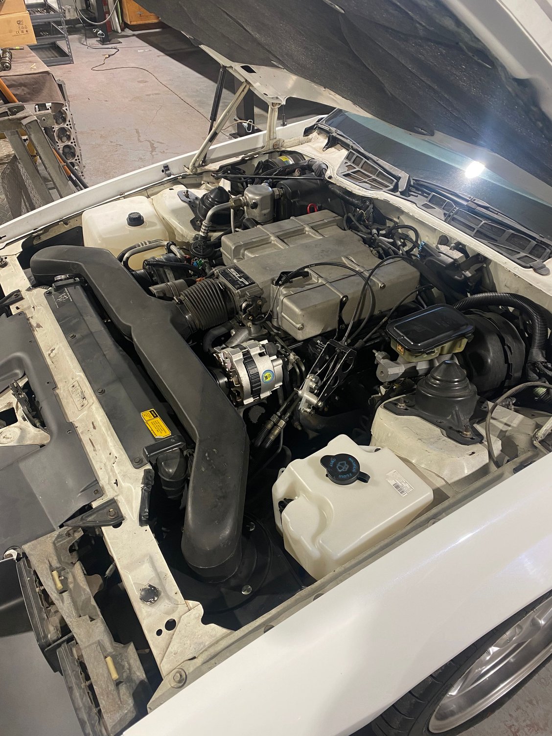

Got it on the ground, and took it for a quick drive today, definitely rewarding to see it run and drive! Still some kinks to work out, but it’s getting close!

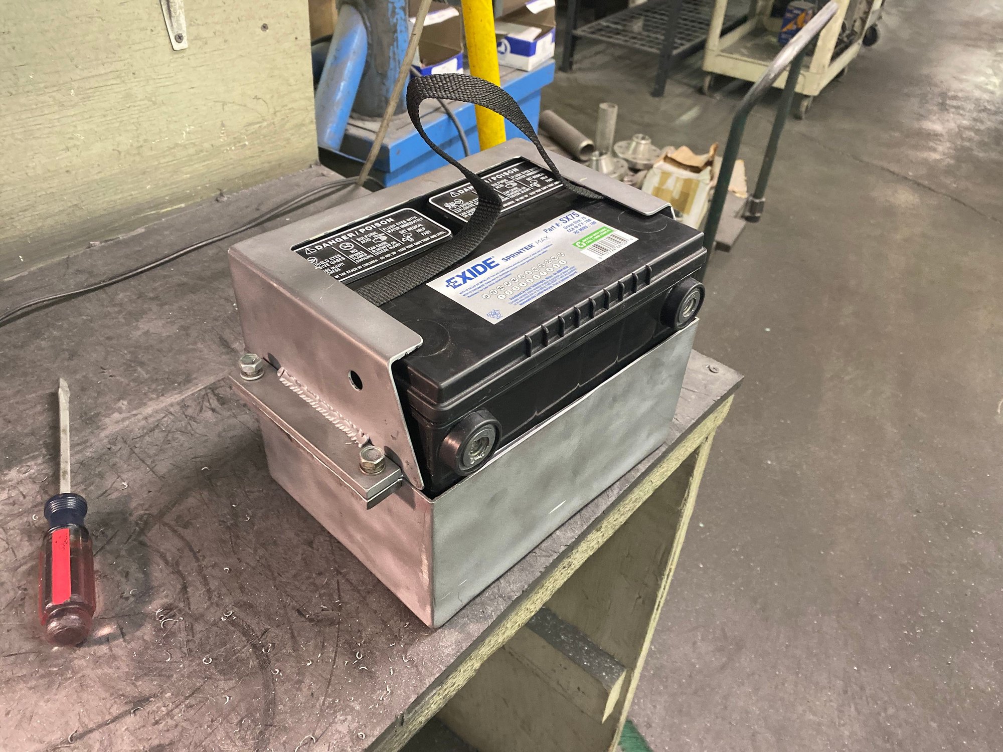

I haven’t had much time to work on the car, but I got a tight fitting battery box fabricated, and started building mounts to hang it from the underside of the factory tray. Plan is have the battery relocated and evap can relocated by Christmas so I can install the dual cold air kit from SLP

That's pretty slick, which side are you going to put it?

Well currently I have finished the battery relocation, that was a chore! Removed the charcoal canister, and mounted the drivers side airbox. Working on the passenger side box now, as well as mounting the charcoal can down low. I think it’s finally on the home stretch before I can have it tuned
