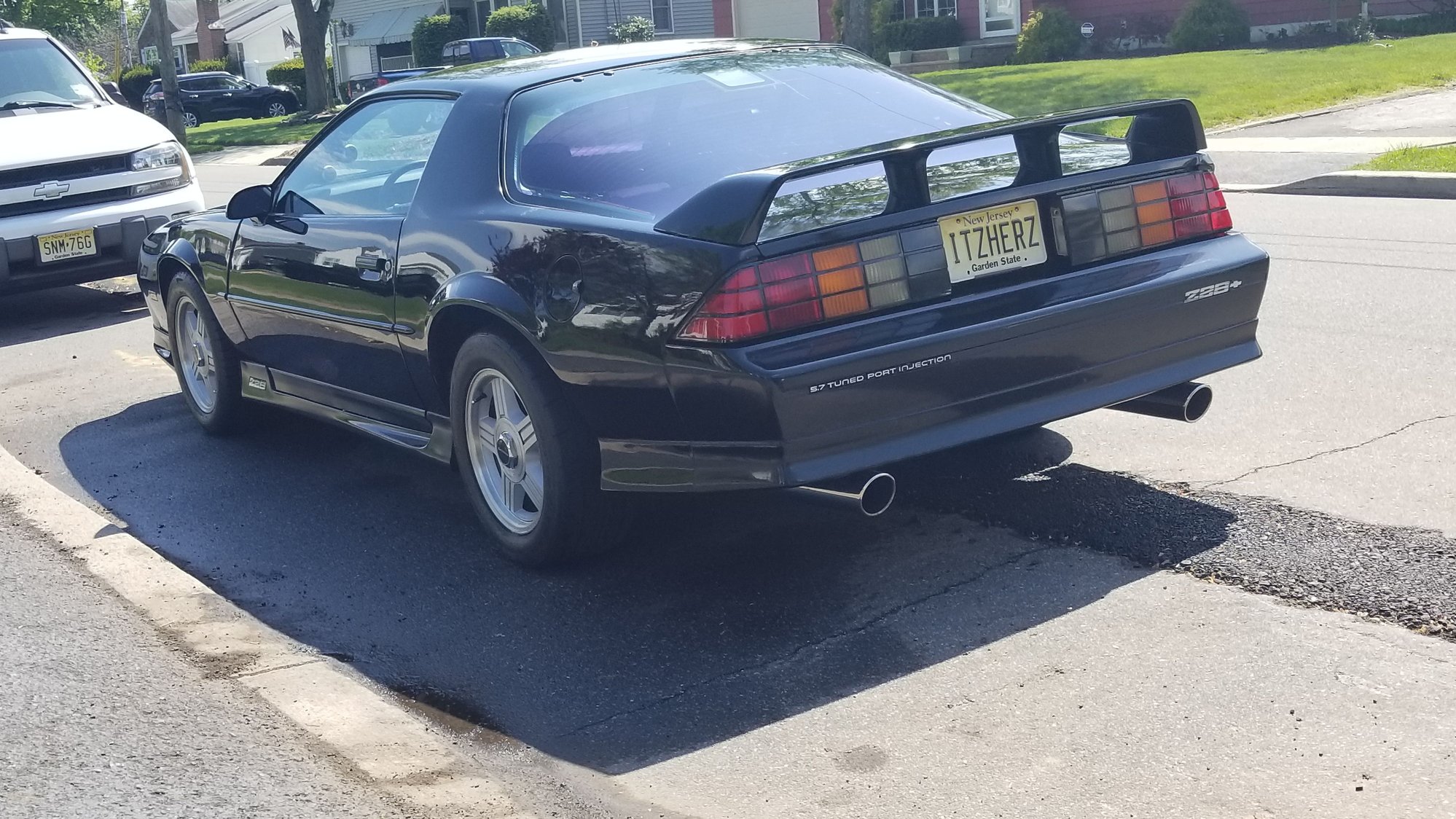

She actually has 2 a 91 z28 350 tpi with an old school paxton on it..that license plate reads itzherz this plate came a few years after so she made it herz2 lol I have my own toys I race..

see lol

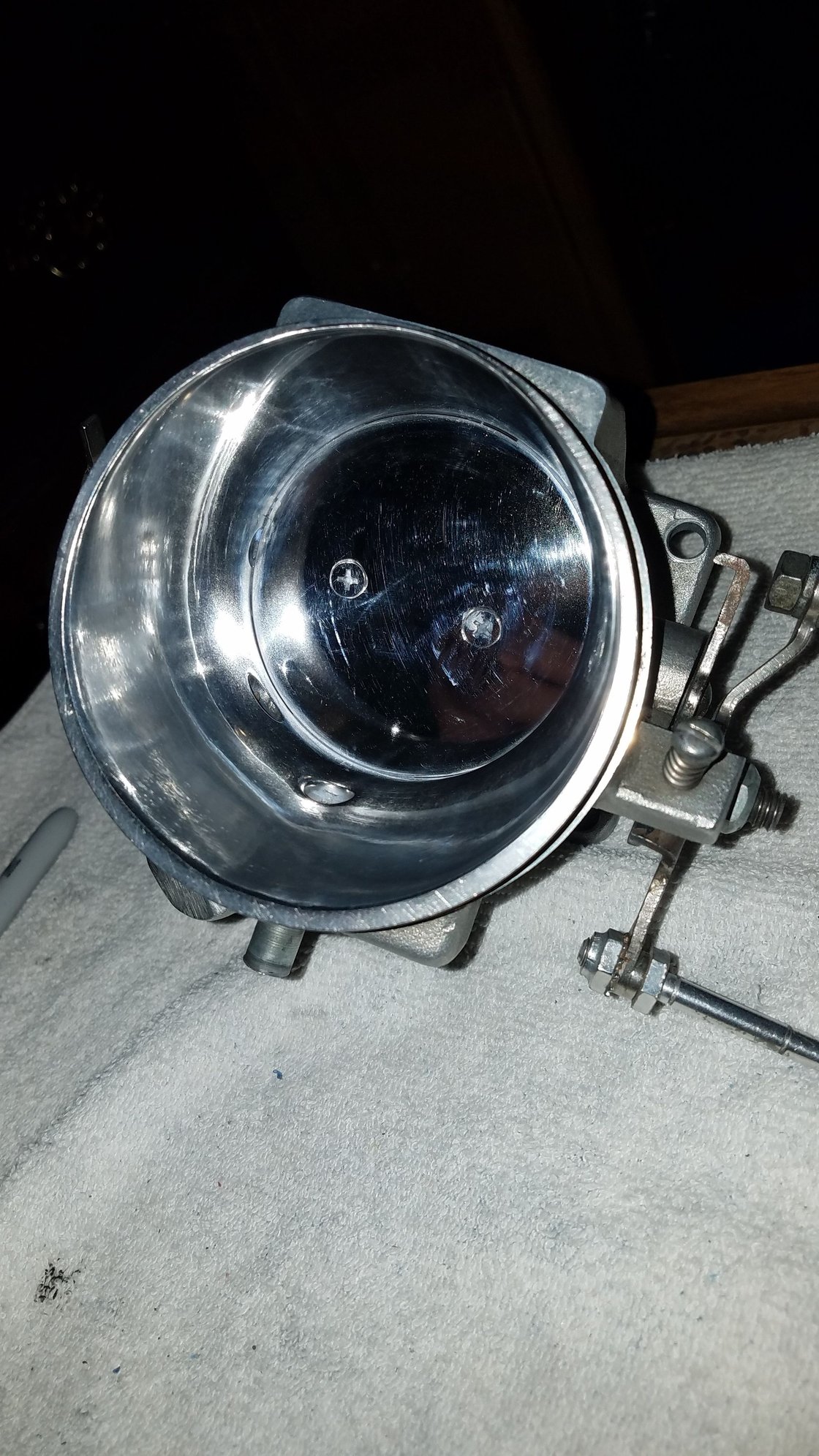

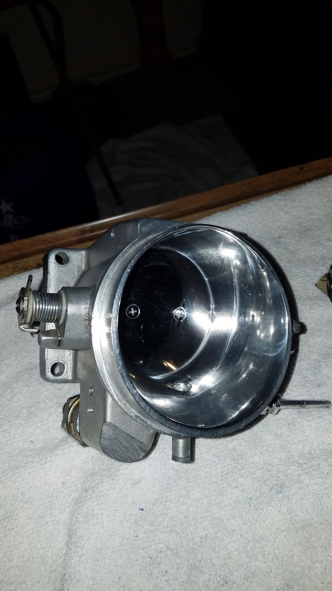

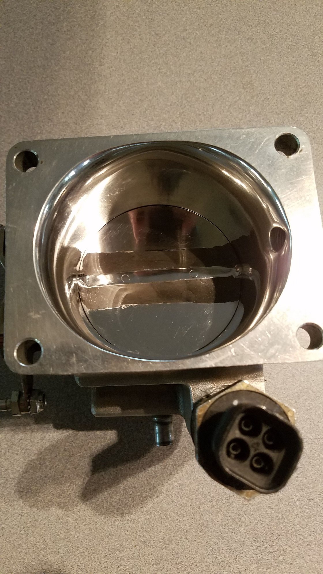

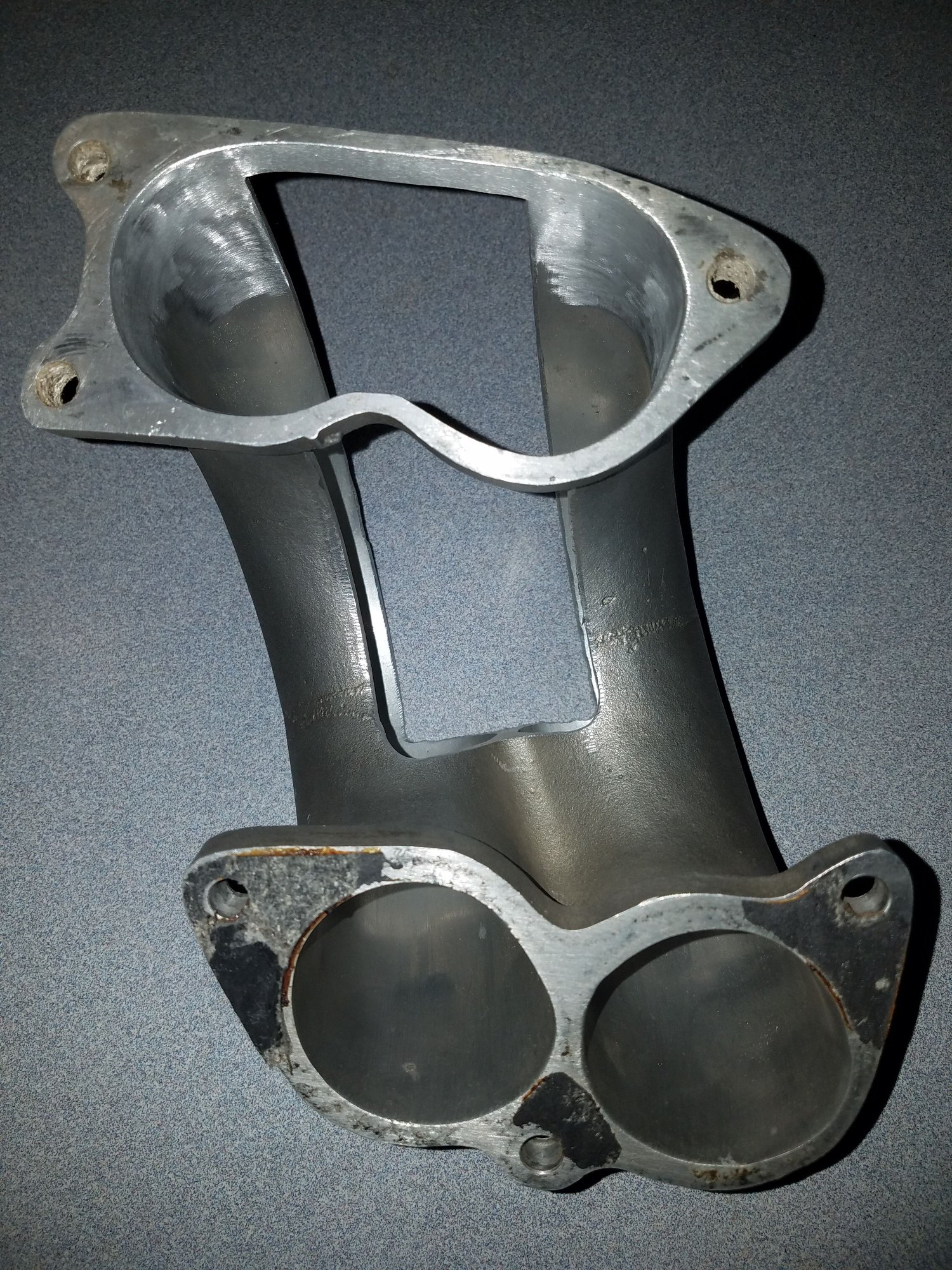

Ahhh, makes sense now!
Yes, I really liked the FIRST. The pass she tried to make was with the original heavily ported TPI/SLP combo. I replaced that with a StealthRam and while it helped the ETs at the track, I really missed that midrange rush and throttle response from the long runners. I ended up practically stealing one of the original AirSensors (FIRST) off eBay that the guy bolted on an engine and never ran - it was basically new It even included all the original AirSensors electronics, which is still boxed up. It gave back 95% of the throttle response and ended up running near identical times as the StealthRam. I liked the intake so much that when I made the decision to sell the car, I put the StealthRam back on it.
I never had a bit of trouble others have reported about the throttle body. Well,,, I did have to use a different spring for the throttle though - the stock one was too weak to properly seat the throttle blade. Other than that, no idle or drivability issues at all.
If you can get a full throttle launch (no feathering) ETs are definitely going to improve. I'm thinking you have a really good shot at high-11s removing the sway bar and running some skinnies. I bought the wheels and tires off a buddy's Malibu and used them when I raced the IROC - everyday driving was a set of 17's with regular Nitto 555s.

Maybe I should try a different spring maybe thats the issue never thought of that...hmmmm

Here is my throttle body

400 cubes and that top end with afr220 may get there. 339 cfm base is no good for a 280 cfm 195 head. 77mm throttle is small too imo. 90mm is typically the size for 550+ hp in the ls world, same would apply to the first if he has a bigger unit available

Nope that's about the biggest the TB will go he does not make anything bigger I was told by the shop that did ours you could potentially make an LS TB fit tho with an apaptor plate.

Ken ported one for us it was 76mm i took it off and put the stock 71mm back on car drives way better we couldnt not get the idle right with the bigger TB

Did you have to change the TB blade to increase the size?

Here is a teaser on what I am doing with my runners. Still have a lot of work to go.
