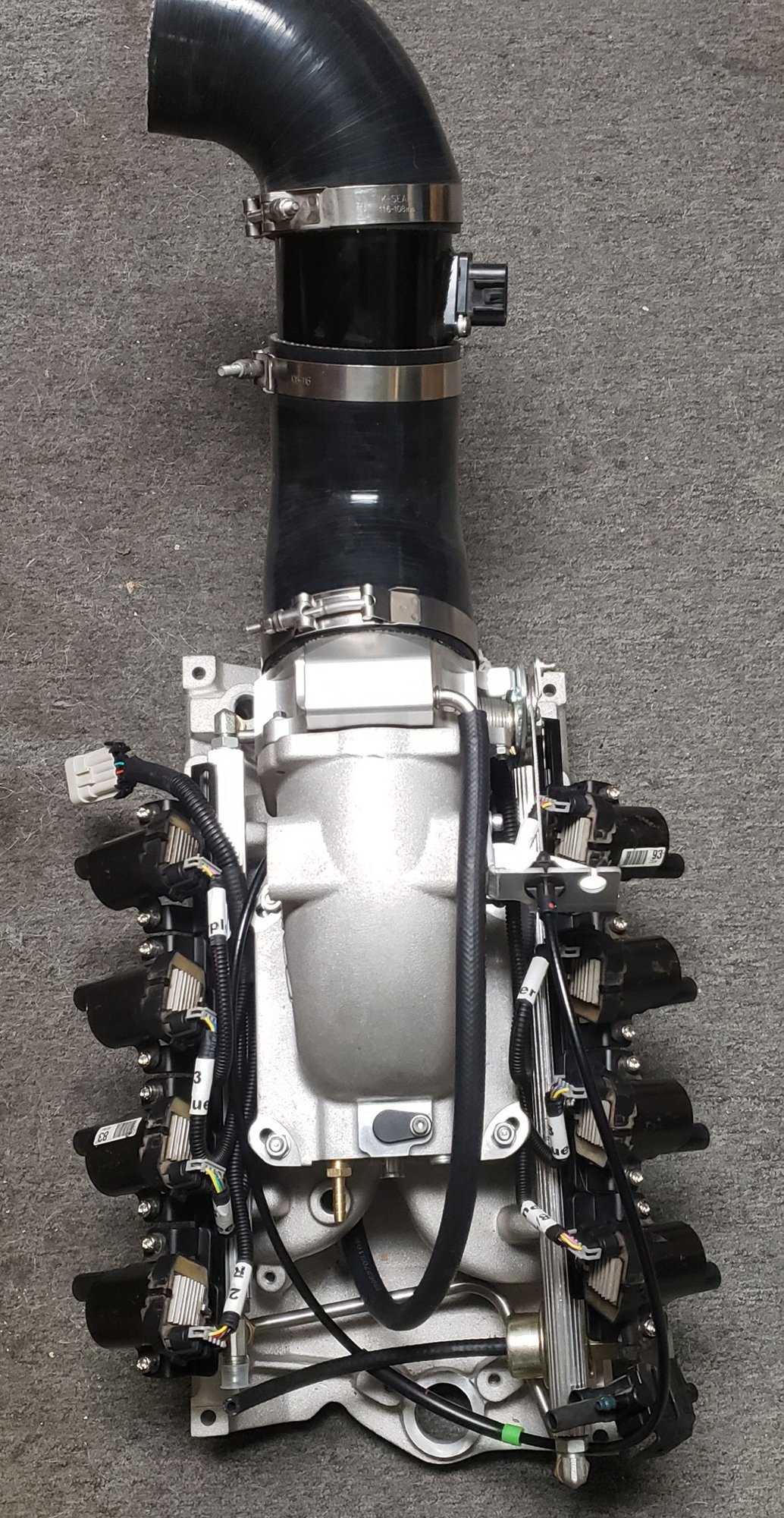

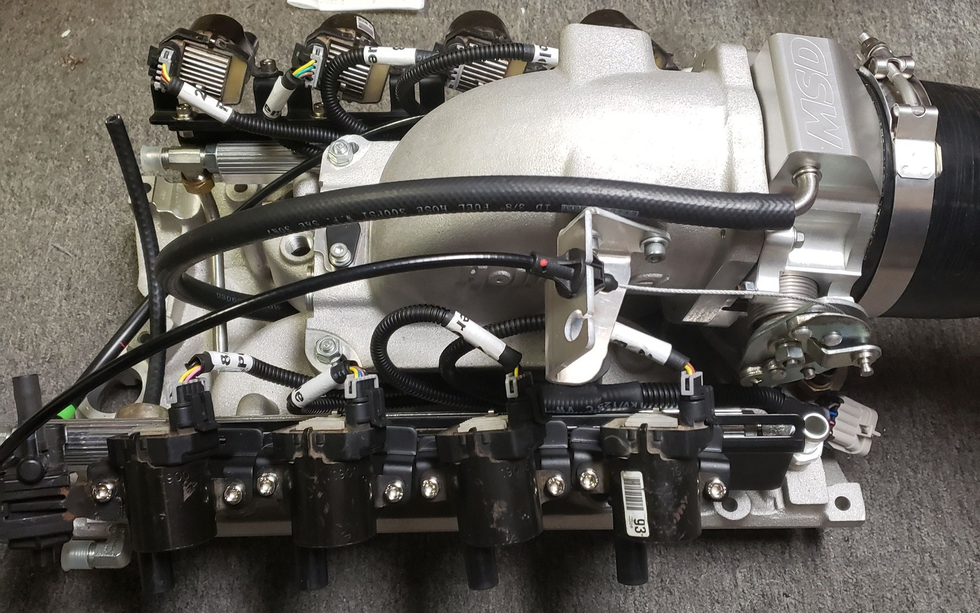

I have had this manifold for a while and finally getting around to installing it. Turned into a bit of a Medusa since I added a set of Proform LS coil relocation brackets that bolted right to the the 2 bolts holding the fuel rail on each side. The 4.5" to 4" coupler looks like it will have to be trimmed a bit so it will be a little less Snuffleupagas of an intake air duct when finished

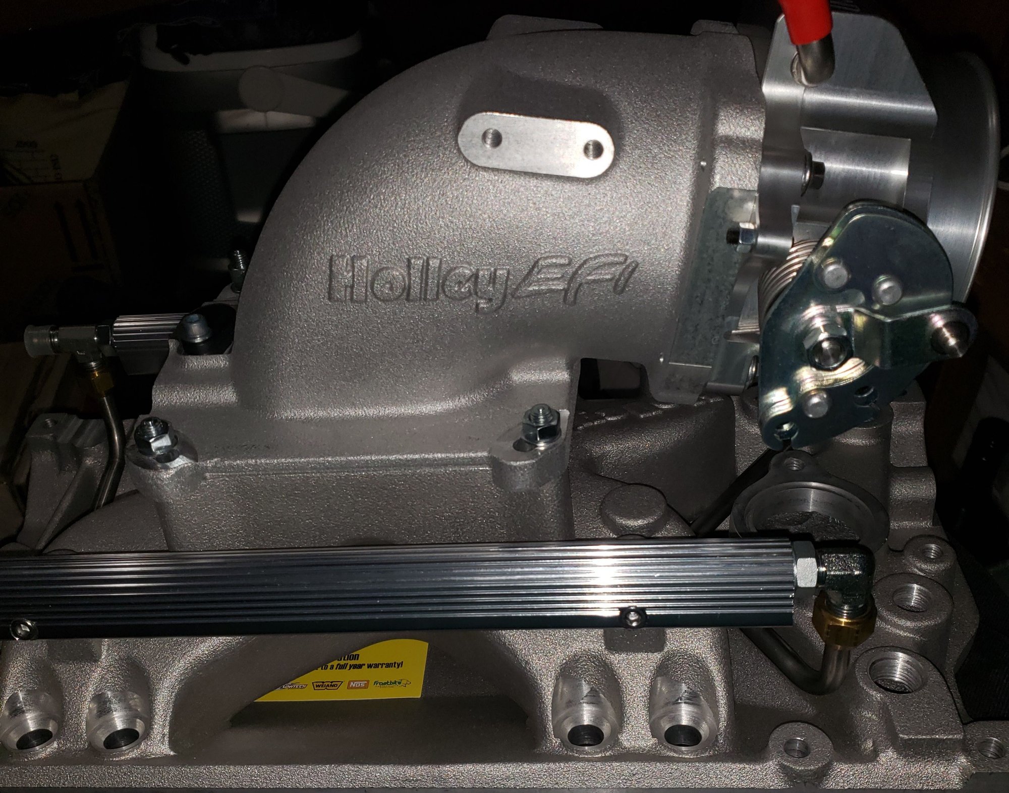

Re: Holley Single plane and 103mm LS throttle body
Interesting. How tall is that above the carb pad?
Old Dec 12, 2024 | 07:40 PM
Fast355's Avatar
Joined: Jan 2005
Posts: 10,430
Likes: 500
From: Hurst, Texas
Car: 1983 G20 Chevy
Transmission: 4L60
Holley states 5.12". With the MSD throttle body sits a bit taller the way it is made where as my Fitech 92mm has a lower profile.

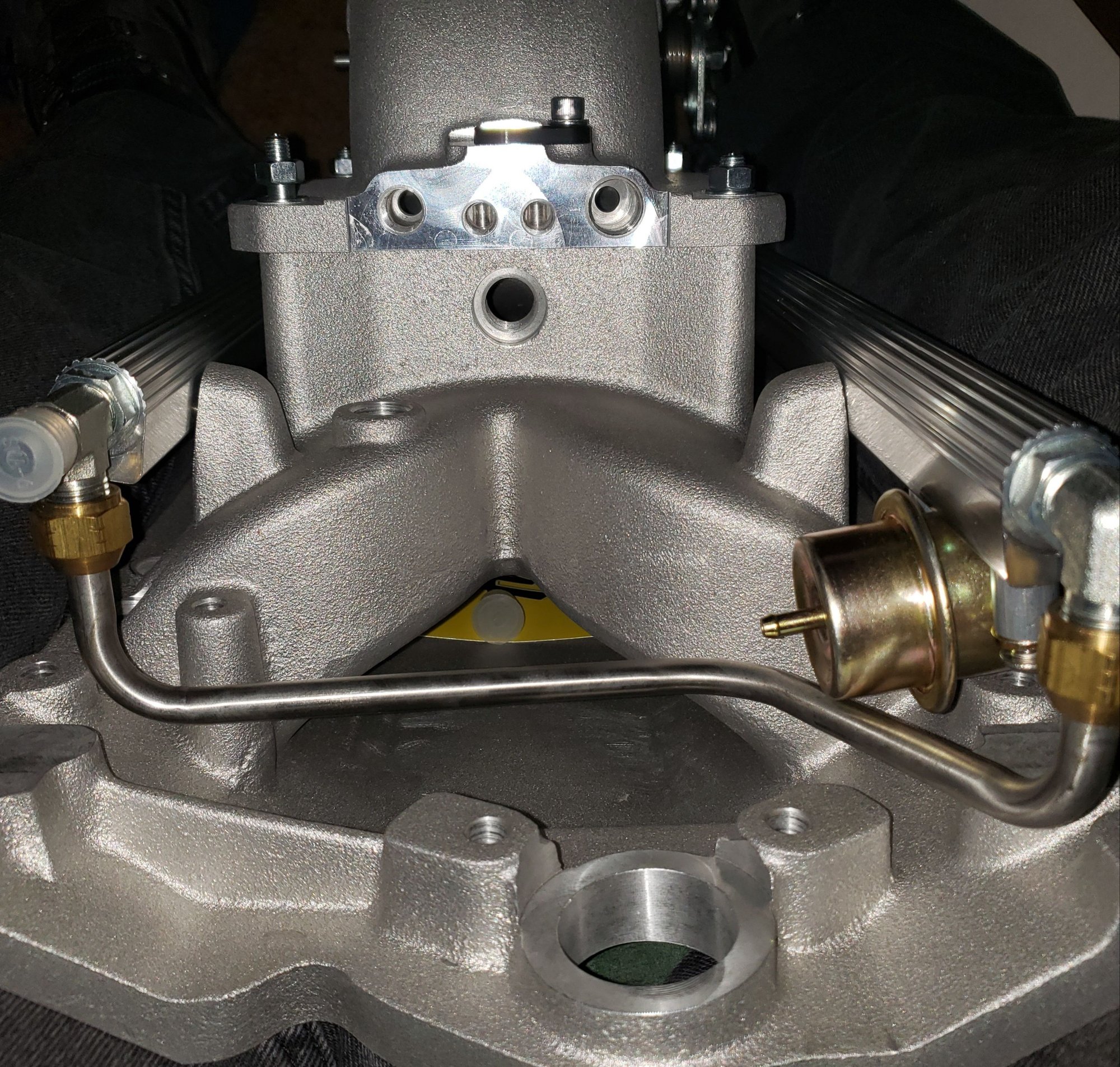

That manifold itself has been discontinued but I bought it during a Holley clearence sale. Along with the rails, elbow and MSD 103mm throttle body. The manifold ports are ~0.100" smaller than my head ports in each dimension but I am not going to modify the manifold in the event I want to run it on a stock vortec head dimension like the Etec170s I own at some point. Even stock port dimension the single plane will easily support the RPM I will spin the 383.

How are you doing the coil on plug conversion?
it reminds me of the setup on my LT1 headed 305
Mine has been running with 24x and drive by wire for months now.
