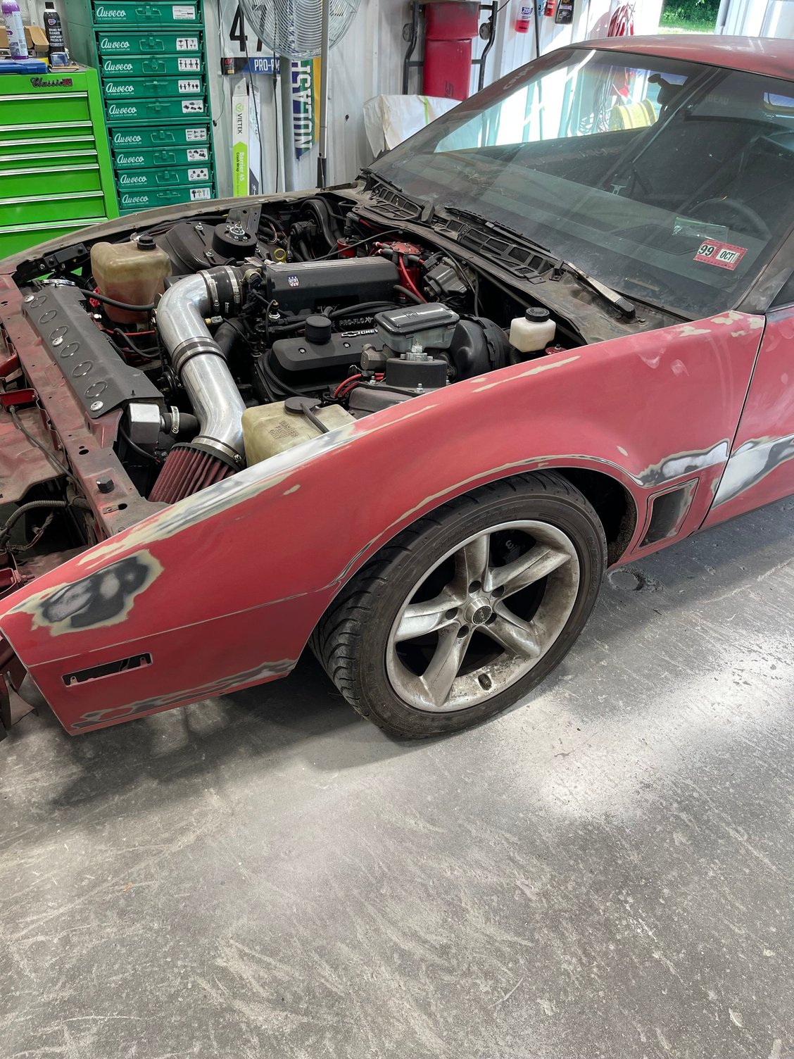

I am running the Holley Sniper EFI gen 1 with distributor. It runs great and the new V2 addresses a lot of the issues with the gen 1. I used a 92 camaro in tank assembly with a 255lph pump and it works great. I also ran new hard lines and mounted a fuel filter under the left side passenger rear seat.
