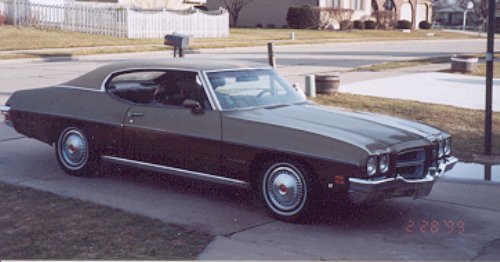

Well as most of you know, I will be selling the camaro to help restore/modify this car. I found a pic of my car on the internet from a GTO website that I took when I first bought the car.
Still was green with the whitewalls/hubcaps!!! lol In case you haven't seen the updated pics, here are some:
My plans for this car are:
Body: GTO nose (fenders, hood, front bumper, valance panel), Vynal Top and side trim removed, new 1/4 panels, and a Judge spoiler.
Interior: I want to replace the bench seat with buckets and a floor shifter (dual gate) Other than that, the interiors pretty good shape.
Engine/Trans/Rear End: A 550 HP SBC 377 (destoked 400, forged crank, eagle rods, ARP bolts, Keith Black flattop pistons, .575 roller cam, Brodix Track 8 aluminum heads, Victor Jr Intake, Holley double pumper carb) for the engine. The tranny will be a built TH400 with a aprox 3500 stall convertor. The rear end will be a 9-inch with 4.56 gears, a spool, and strange axles. Exhaust will be dual 3-inch.
I hope to have this done sometime next year. But more than likely by late 2003-early 2004. Its been my baby ever since I got her at 17 yrs old so its about time she gets restored.
