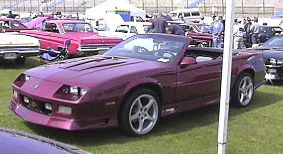

2000 C5 Replica Wheels, 18" x 9.5" 63mm offset, 2.25" spacer for front wheels, 4th gen rear. Wrapped in Kuhmo 712's 275/35/18.
Not as good of a shot...

Well there are very few of us (so far) with 2k C5 Rims, and I have yet to see a set of 18's like mine! But not saying that more people won't get them in the future!

9.5's fit fine, but they are close.. no doubt! I got mine from tbyrne motorsports but I don't remember the name on the box of the actual manufacturer, began with a D. I got a 2.25 spacer from Skulte (I though it was going to be to big but it's not) and I bought a 5/16 spacer for the rear just to even the outer edges (4th gen rears have longer studs).
