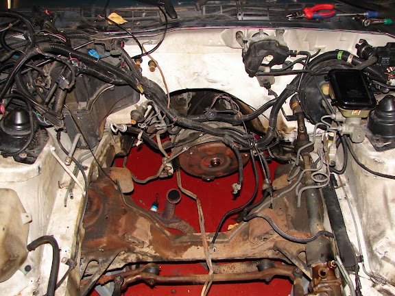

Ok, this is what it looked like:
When we pulled the engine:

Sorry about the quality of the pics, the lighting (And haze) in the garage is terrible. :/

looks about like mine did lol. just be patient with it and do your best quality of work on everything you do. itll all pay off in the end. to paint it all i did was take a scuff pad and scuffed the hell out of it. just get all the shine away, then i put about 3 coats of primer and let it sit for a day. then i put one coat of black on, let it sit 15 mins, put another one, let it sit 15 mins, then put the third on. let it sit a day. is that how you painted yours or did you do somethin different? when it was all dry and it was fine. im just taking my time. i put maybe 60 hours into it so far.

Here's what I'm starting with.
