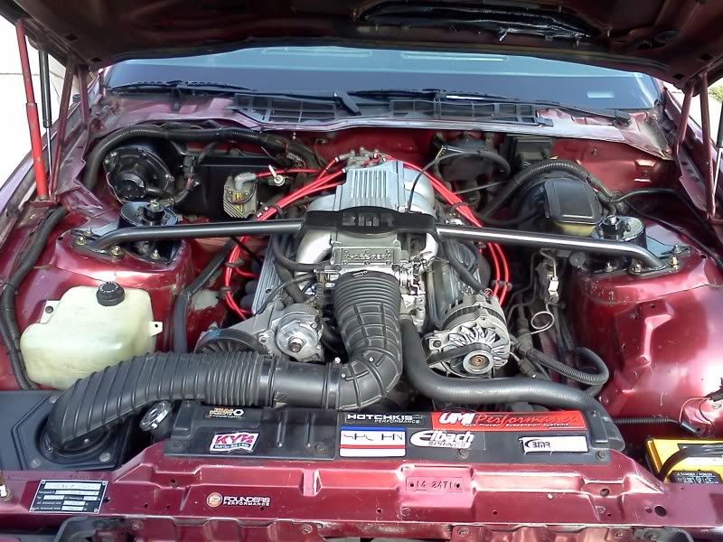

This is currently what my car looks like under the hood. All emmissons equipment has been removed along with a full AC delete and removal of cruise control. I've still got my bottles, but those may disappear in the future depending on what cool things I can find to replace them. Also, all wiring has been moved to the outside or hidden from veiw so it almost looks like and old school ride when you open the hood and it's all motor staring back at you...
The engine bay isn't perfect, but it looks better under there than it did when I bought it in 2005...
At some point in the near future I'll be replacing my brake booster, swapping to a LS1 style master cylinder, and getting new cast/camber plates.

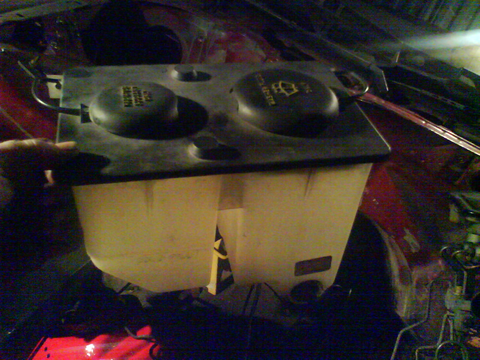

Here's some pics of the bottle. Like I said, the car is stripped bare from the firewall up for the V8 swap, but you can get the general idea. Sorry, they are a little dark but all I had was my cell phone.

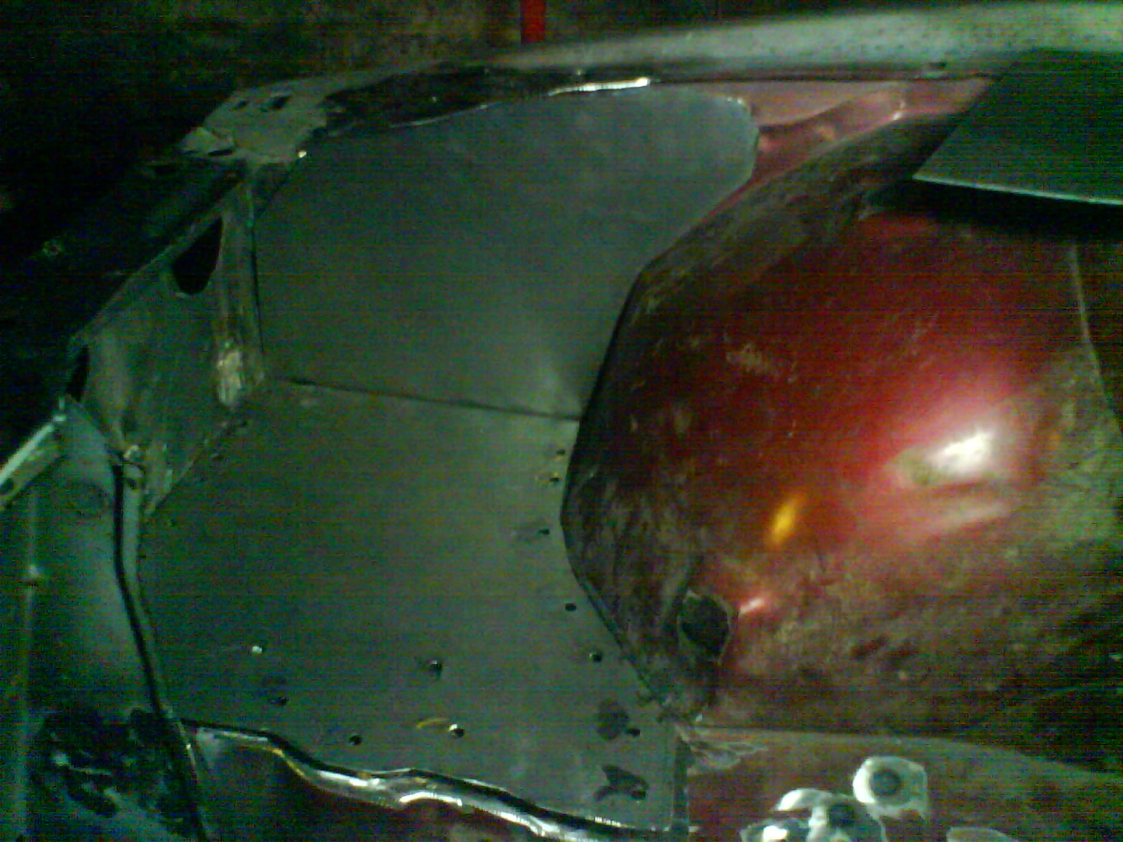

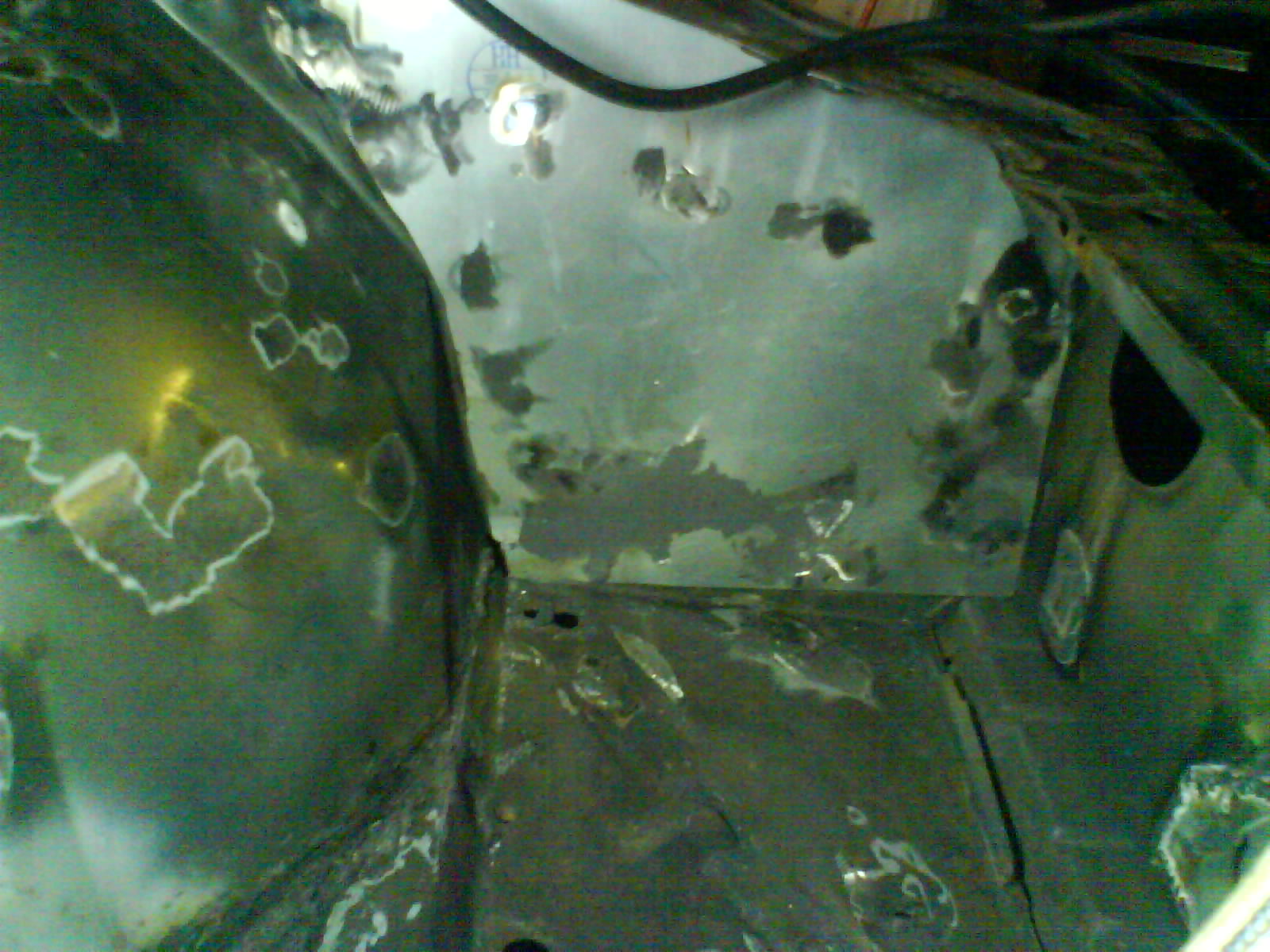

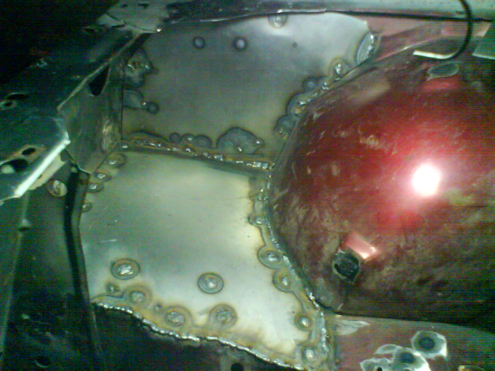

Here's some progress pics of the battery trays after I got the sheet metal welded in. It's all the pics I've got so far of that process.
Had to put off any more smoothing work so I can get the car back on the road for the summer. The car is an ongoing summer driver/winter project so I figured I can always finish it next winter.

What kind of bottle are you using? What did it come out of?

I pulled from a Ford Explorer at the local U-Pull. Not sure of the year, but I think it was an early-mid 90's. I'm pretty sure I saw a Ranger there with the same one.
