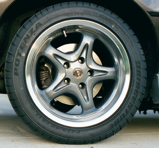

Those look like the ones! They look a little lighter than I remember tho. Where'd you find them?

is that a rim on the emergancy tire?? I'm just wondering cuase that looks like the emgerancy tire, LMAO, HAHAHA!

Found them in the readers rides. I have no idea what size/offset they are. Sorry

I'd hazard a guess and say they're 17x9 (considering the tires are 275s and I don't think ROH makes a 9.5" wide rim, only 9").
If that was the case, then you'd want a 5" backspacing.
And those are badass tires, that's the exact tire I run (size, brand, etc.).

It'll come to where it is in that picture: just inside the lip of the fender. My car is lowered with Eibach Pro-Kit springs, and it still never rubs. There's about a one-and-a-half to two-finger gap between the top of the tire and the edge of the fender on my car.

Can you still get those rims in that color? They are really sweet.

Those are the ROH ZS wheels, in their "BLACK ICE" finish...I'm pretty sure they still make them...

I have 275/40 tires on 17x9 ROH Snypers which have the same backspacing as the ZS. My IROC has been lowered with Hotchkis springs, and I had a little bit of rubbing on the lip of the rear wheel well before I rolled it up with the handle of a baseball bat.
The backspacing in the front is just about perfect.
If I had an additional 1/4 inch of backspacing in the front, I think the wheel would hit the end link.

For the ZS style you can get 17x9.5 and 17x8.5.

Seem alittle to thin for the rims on our style of cars. However some like to show of the disc brakes, I dunno why... I am waiting for the day when someone shows me a picture of the rim with one spoke (is that how its spelled?) THE L-RIM
