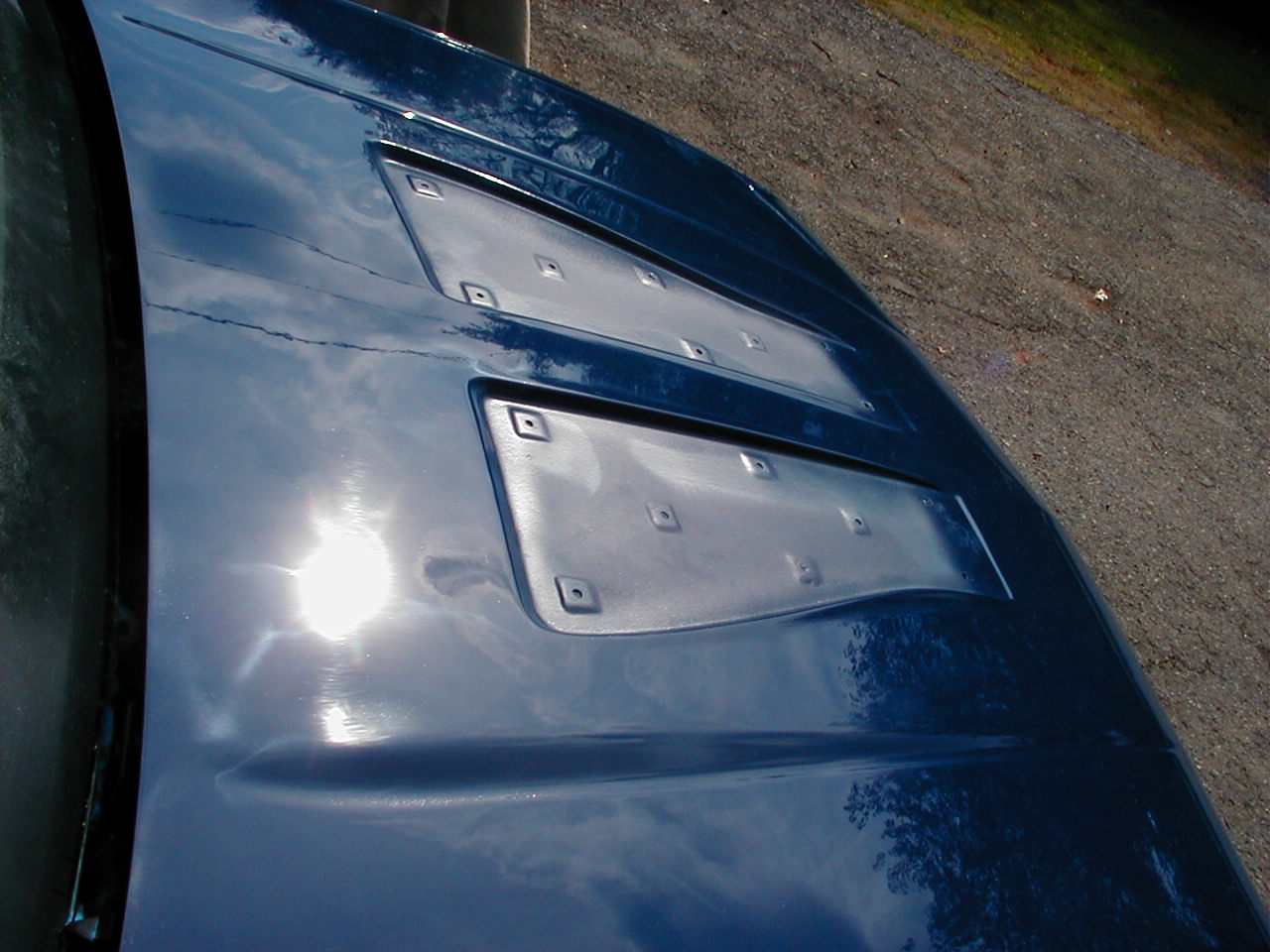

Careful when wet-sanding clear !! There usually isn't very much clear on a car and wet-sanding removes more then you might think. I'm NO PRO, but I've put done some 'detailing' work before. I'd advise you to try polishing FIRST, Then Buffing if your still not happy with the results,... only then would I try to wet sand (a little) ,.....then buff, then polish.
Start with super-fine paper and change to a more aggressive grade only if your not getting good results.
I hand-sand with a semi-flexible pad/block
Used Wool pad for buffing, Foam for polishing.
Any compound will work, I like Meguiars.
When working 'start-to-finish', I'd prefer working on 1 area at a time,... wet-sand the whole car (section by section) then buff the whole car (section by section). If I have to walk away from the project for days at a time I would buff any areas already sanded before taking a break from the project,......
This hood was painted with single stage urethane, then most of the orange peel was wet-sanded out and then buffed:
