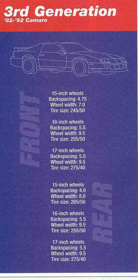

anyone with the chevy high performance mag from last month with the tire sizes, what did they list as the biggest front tire for a 3rd gen on a 15"rim, 16"rim and a 17" rim and biggest rears for the same rim sizes, please help buying new rims/rubber very soon

Enjoy - good luck with your new rims/rubber!
Steve
