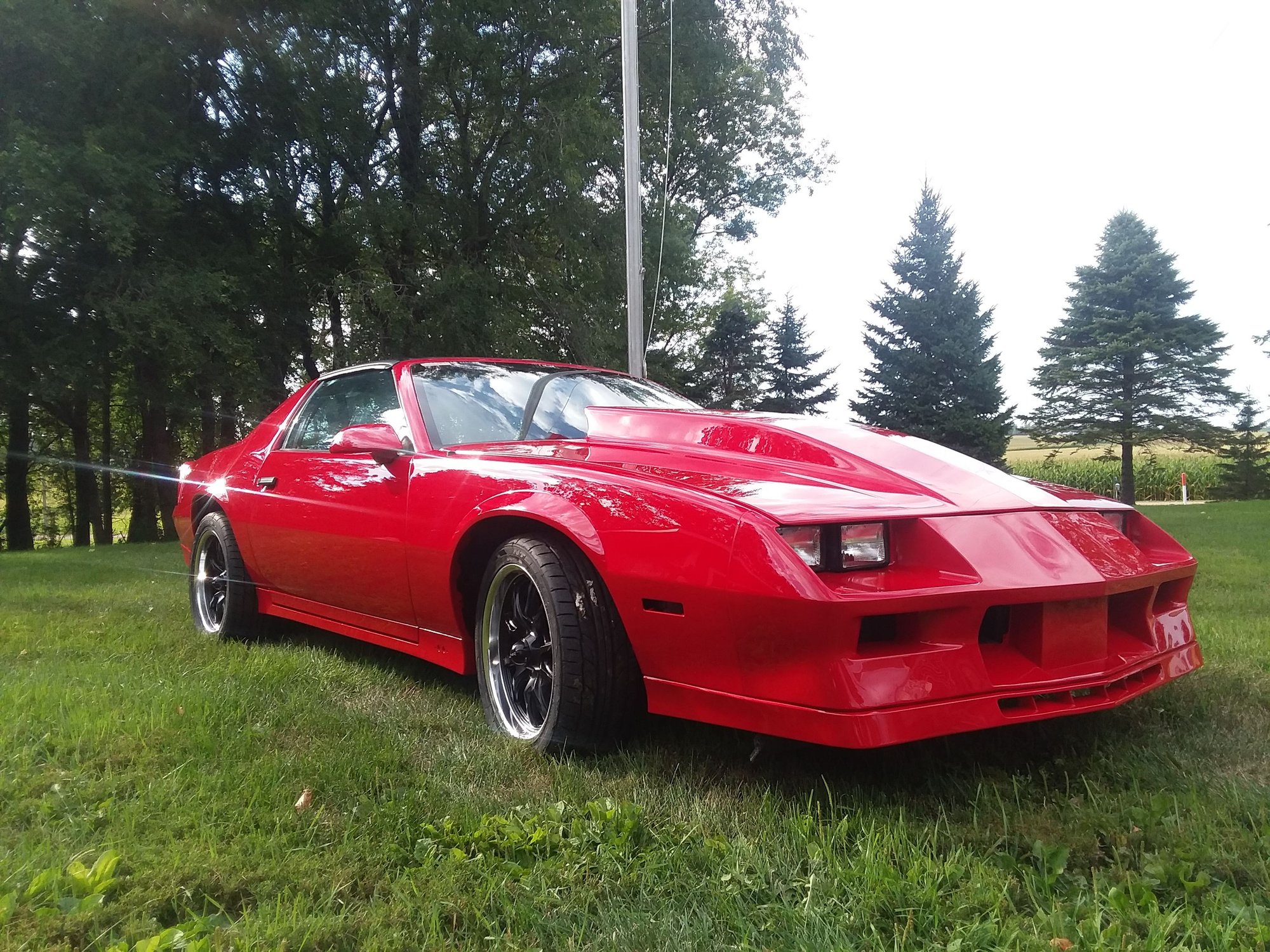

Been a long time coming. Like to thank everyone for the help along the way. I have a good handful of threads from building the engine to brakes to rear ends. Some day I should prob sit down and make a build thread so y'all can see where I started from and everything I did to it. Nothing super extravagant but looking at the car makes a guy happy knowing he did it w his own hands. Yup, paint too. Theres Still quite a few things left to do but am hoping in a month or so to have it road ready.
Again, thanks for the guidance. Enjoy.

84z28, 383 480hp 500tq, ruthless racing built 700r4, 8.8 rear 373 gear.
Msd 6al programmable
750 holley
Rpm intake
Worked over Dart pro 1 heads
Comp roller valve terrain
custom cam from Powell machine. Cant remember specs off top of me head
Molnar rods
Scat 9000 crank
Canton pan
Fluid damper
Block is a 74 4 bolt main.
Nothing special really, wanted a solid motor I can beat on and not worry about it.
Ford 8.8, strange axles, Yukon guts
Custom made torque arm, lcas, pan bar and trans mount
Custom 304ss exhaust
Kenny B sfc
Eibach springs, tpis custom valved struts
Ls1 brakes
The car has just about every option from factory. 70k on the odometer, very clean solid car.
Thanks man!!
