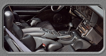

here's a pic of mine, bolted right in with little trouble

I am in the process of putting a 4th gen automatic console in my 86 Firebird. While not a Camaro, a couple of my issues should be the same. I used a 01 automatic console off ebay.
I had to do two things. I had to move the shifter assembly back about 4 inches. This is because the later model consoles are a little higher in front, and thus need to move back a little to clear the radio housing.
The other thing, was no matter how hard I tried the part on the console plate that fits over the shifter would not fit and let the console sit all the way on the floor. The reverse lockout switch in the side of the shifter interferes with the bottom of the plate. I had to cut off the section of it that goes over the shift handle, and the two pedastals the screws that hold it on that side mount to. Now it's just an open hole over the handle, and I need to find soemthing to cover it.
I think it would fit better with an actual 4th gen shifter assembly, but not sure. I'll have to take a closer look at my 94's shifter and see the differences.
Anyway, I'm pretty happy with the way it turned out. I'll get some pics when I have time, but I'm rebuilding the tranny in the 94 and that's taking up all my time at the moment
