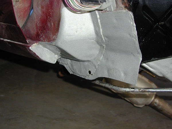

1. Take a close look there may be more...
Pull the plastic fender liner and look here...
