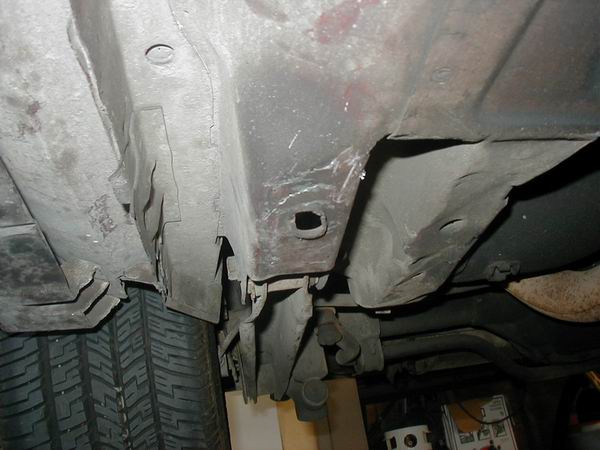

I'm an idiot - Show me the jack locations:
REAR:

right where the lower control arm is attached to the subframe is a good spot, but I usually jack it by the differential, then put the jack stands where the LCAs mount.

I've used this point:
