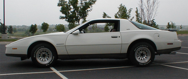

I took my 1983 Firebird to my schools shop this week for an oil change. I had only 10 minutes left of class, so I was a little rushed to get it finished. Me not thinking, and working with a bunch of little inexperienced freshman kids, the car was lifted with the front jack arms right behind the front wheels instead of the subframes.
What was the result? A fresh 5 quarts of oil, a fresh new oil filter, and an f'ed up car....
Not realizing it untill after the bell rang and everyone jet off for lunch, but my drivers side door now hits the front fender when you try to open it. It only moves a good 4 or 5 inches out before it hits. The whole door looks pretty whacked out of alignment.
Ya know, its a real pain in the *** having to get in and out on the passenger side of the car.

IF I understand what youre saying you jacked the car up in the spot behind the front wheel where the stock jack would go.? If thats the case what you have done is bent the tab on the bottom of the fender where it bolts to the underbody. This is a common problem with these cars. The fix is simple. Get the car back up off the ground, and take a hammer and smack the tab back to its proper location. Its probably bent up under the body, so it needs to be smacked back out. Once its back in a close to right location check the door and see if it hits. If it still hits check to see how even the fender and door seam is. You may need to use a body washer to push the fender back out some. Ive had to fix both my cars of this problem on several ocassions.

yeah that's what i was thinking, he probably just bent the fender mounting piece. i don't think you would screw up the door alignment unless you actually jacked it up on the door.

that was my thought, also. try realigning the fender. if it really is a body problem, bring it to a body shop. they can straighten the car.

Here are some pictures that I took after I walked in from work. I hope they help show the problem a little better. I'll hopefully be able to tear into it soon.
Http://www.freewebz.com/blargmaster/pic1.jpg
Http://www.freewebz.com/blargmaster/pic2.jpg
Http://www.freewebz.com/blargmaster/pic3.jpg
